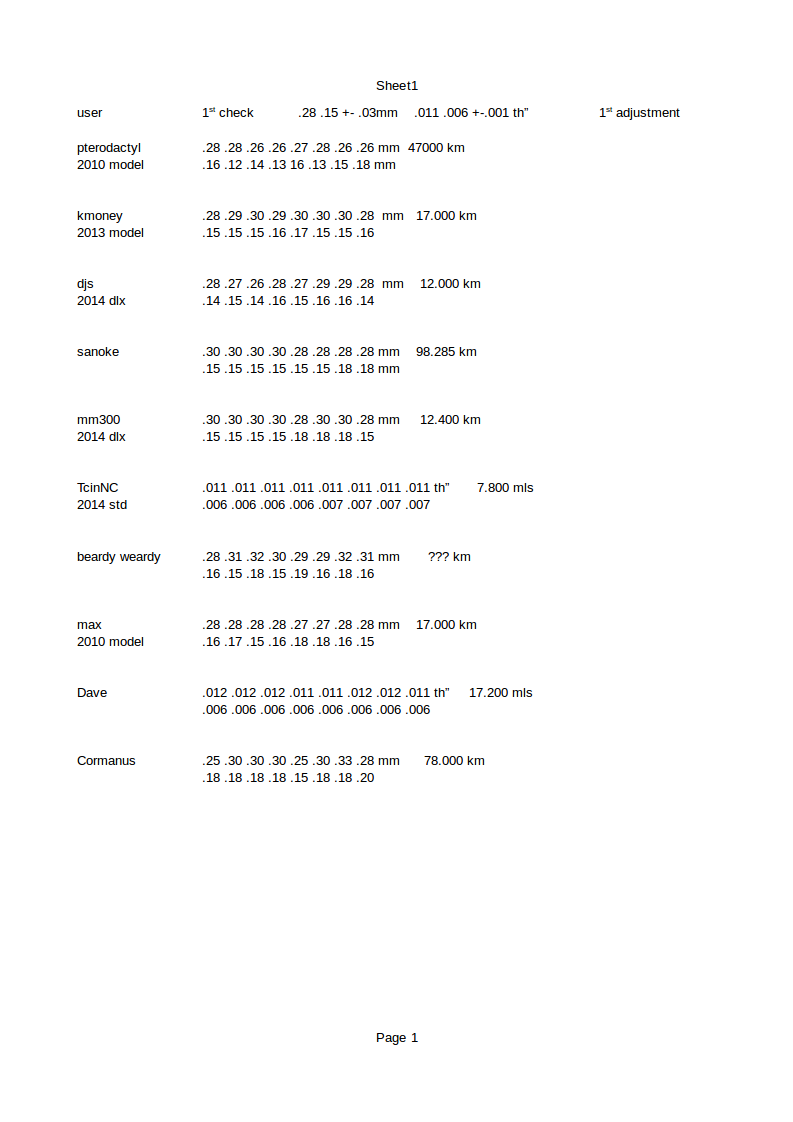

Because Pterodactyl wanted to keep the thread brief i made a ( my primitive first ) spreadsheet and will try to attach it to this post, see if it's any good
or;
[Image: 4ebfd79f09a6445fdc71cc1e2e06ebfd.png]
Did i mention it was primitive?
max
#77
Nice one, Max. You could do it in Google Sheets and just provide a link so those who wanted to could update it.
#78
Max, this is great! My bike is a 2014 Dlx.
#79
Thanks for the advice Cormanus, i was hoping you would come up with the idea ( clairvoyant ? ) .
Had no idea google sheets existed so googled it and bungled my way around it, turned out i could just copy my"valve.ods" file and pasted into google sheets, gave it a name and there it is.
Have created a link that says everyone can alter the sheet;
https://docs.google.com/spreadsheets/d/1...sp=sharing
To enter data just click on the cell, it highlights in blue and type in what is required, it auto saves as far as i can understand, so you can just walk away from it and it's done; neat and easy.
All done Dave.
Ahhhm kinda don't know where to put it now so it is easy to find for everyone else......help!
max
