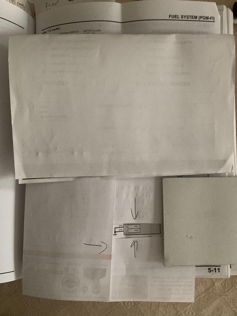

[Image: 66b3de84ec0a540ea2f3a3357f6c47dd.jpg]
2 x pm sent
Pb,
That is a chassis ground on pins A23 and A24. They go to Popgun 1 and Popgun 2. The ground is supposed to inhibit snarky posts like this one. Doesn't work, as you can see... Big Grin
