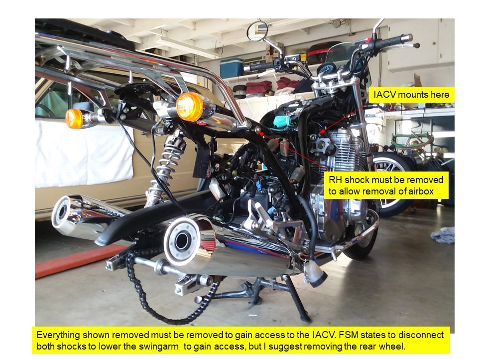

For all the work I went through to replace the IACV (I followed the Honda service manual and removed the entire rear fender to allow clearance to remove the airbox) I would have prefered to replace, or reprogram the ECM, but the reprogram option wasn't available five years ago, and I had no information available then that replacing the ECM would work. My bike was examined by an authorized Honda dealer at that time, under warranty, and they performed a computer diagnosis that didn't find any errors. As luck would have it, the problem was not present when I delivered the bike to the shop.

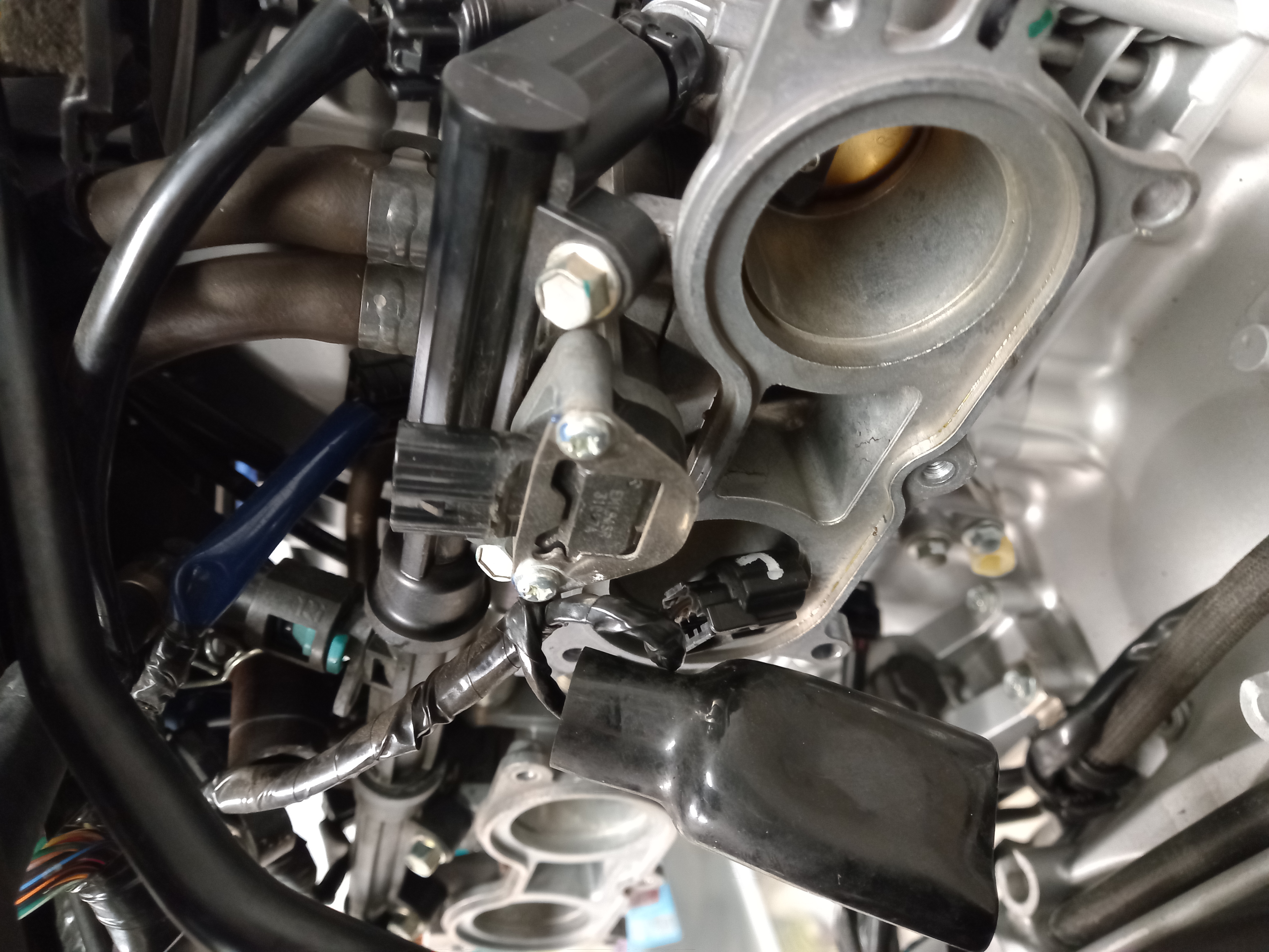

you did this?
[Image: c7c1f623802153ac2117d3bace683bc4.jpg]
[Image: 250b6739f6c2f150fd5a142a68982c98.jpg]
I disassembled lessSmile

How much forcing and bending to the air box did you have to do to get it to squeeze out? I was afraid I would break the air box if I tried to force it out.
