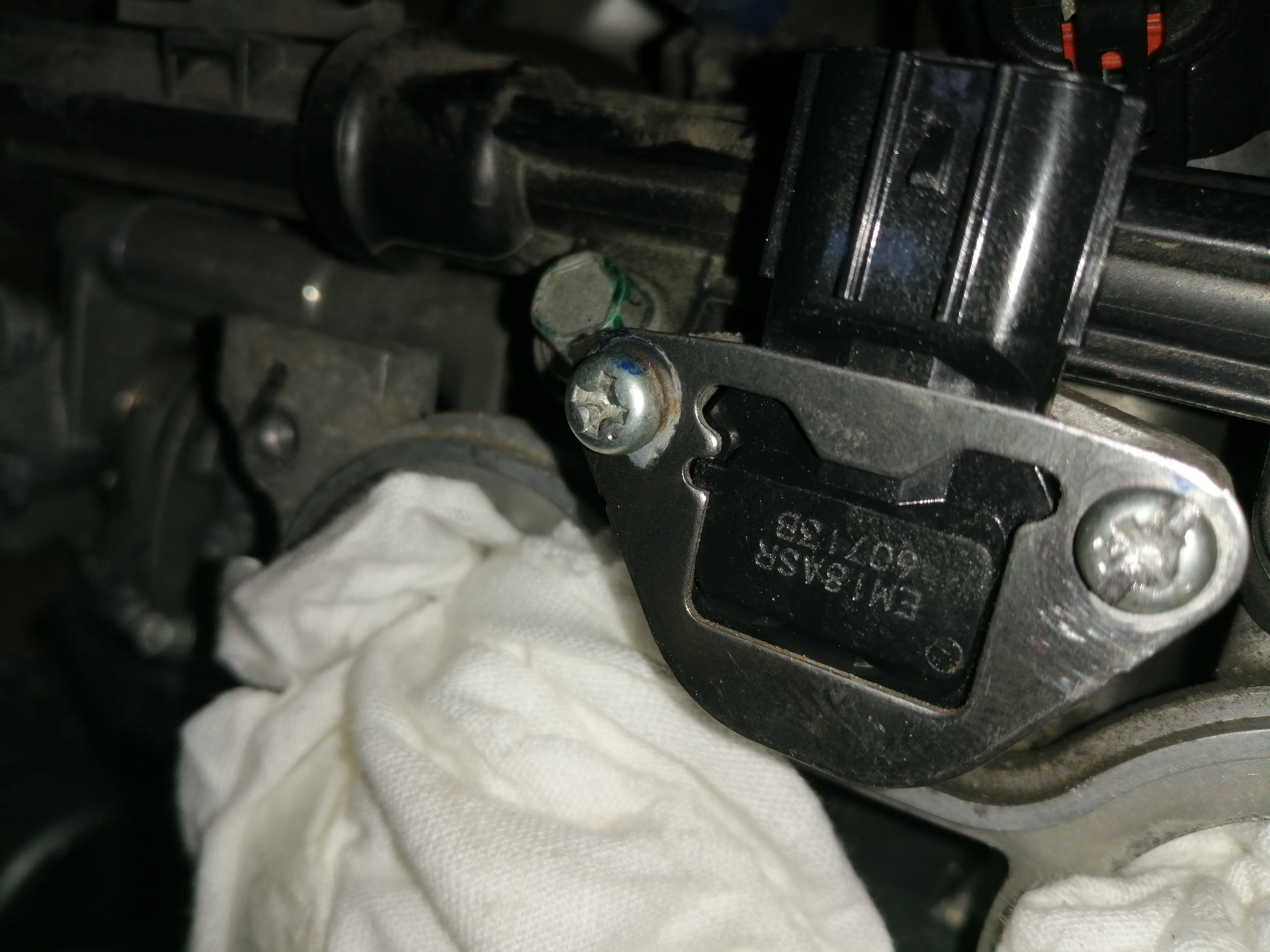

Yesterday I removed my old IACV looking for coil wiring, magnet or mechanical fault. The housing and the spool of the valve do not show evidence of wear nor any kind of marks

After all the checks I have not found an evidence of failure. Always thought that one of the magnets in the rotor could be weaker than the others thus failing in one of the steps and tyhen not being able to keep on turning in the same direction again. I made and induction test where I could check the whole set of magnetic field intensity and coil wiring

As I said I have not found a fault anywhere, it makes me think of a mechanic failure probably in the spool of the valve, I has two separate bodies joined by a spring and you can turn one in respect with the other if you slightly force it, where the system could loose the real position of the valve and giving a mistaken fuel mixture after that. I want to emphasize that my issue was LOW IDLE, never had high idle issues
That is quite an accomplishment speed, thanks a lot for the pictures.
I have always wondered what the iacv looked like inside, you can see the poles inside and the offset of the two coils to produce the different step positions, these steps are very small indeed, can you measure if the rotor has more than two poles with another magnet?

Two things i noticed;
1 the pin in Speed's picture seems to protrude ( stick out ) more than seems necessary to guide the piston and;
2 Pawel's piston appears to have a wear mark inside the groove on the bottom at the iacv end.
This is probably not important since the fault went away by replacing the iacv but it just struck me as a bit suspicious.
