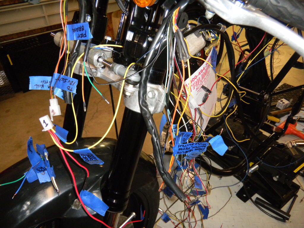

Some updates
Electrical isn't my favorite thing.
[Image: fd5bc60792187d9256a73329e0a2e703.jpg]
Right side finished
[Image: b488ee37bcd1d371d70f56d1179b4dc8.jpg]
Left side looks the same under the inner tube, just a lot more wires. Had about a 1/4" clearance between the tank, needed a little insurance.

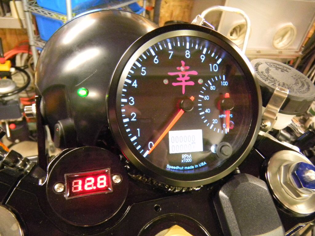

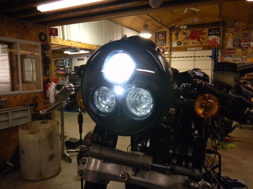

"Dash", GPS antenna on lower right, green light is neutral indicator, switch on headlight housing is for the low beam (high beams are triggered through the hi/low switch or the pass switch. Volt meter is to keep track of the vintage technology.
[Image: 4b19e2ce29a52c0e3017888da2959c2e.jpg]

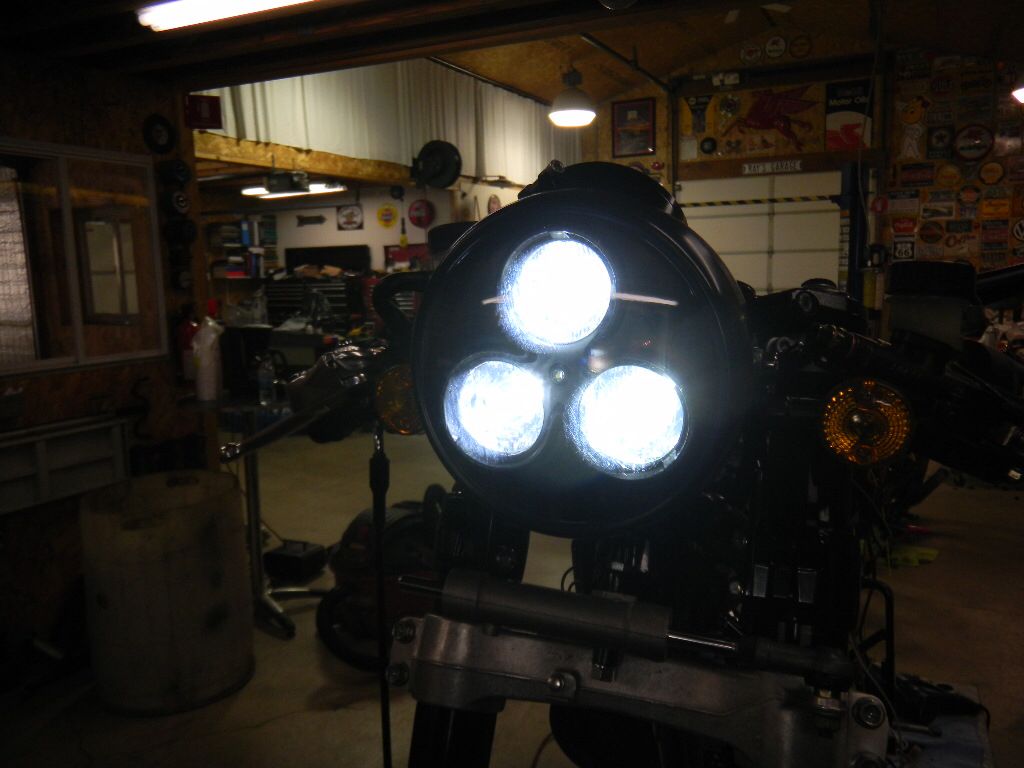

Low beam
[Image: dd4fbcd99e535ba5888ad650cb0f616b.jpg]
High beam
[Image: 02be0b6460633dd3a87bb94a3d5ffac0.jpg]

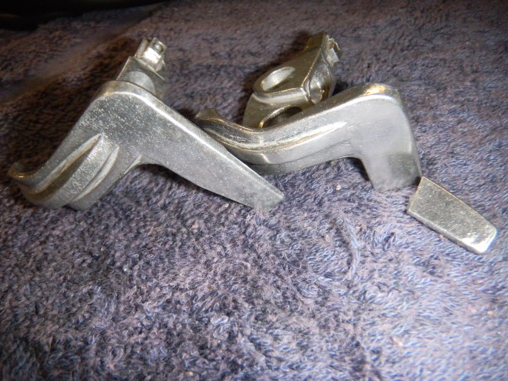

Edit, forgot the photo of the front brake micro switch lever. Broke the original trying to heat & tweak it.
Left is the replacement, right goes on the wall of shame.

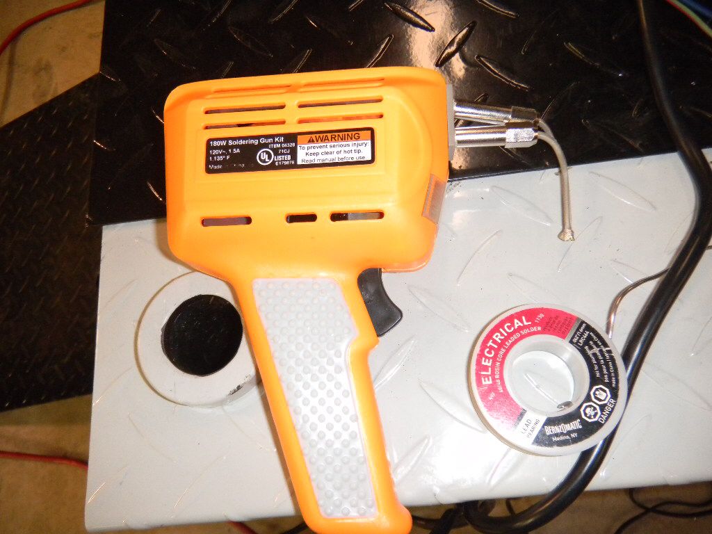

Seems like they'd do drop testing for soldering guns from 2ft. Had this one for about three years, bought it at Harbor Freight.
[Image: e4550d3654565bd0f69e8594d7a9933e.jpg]

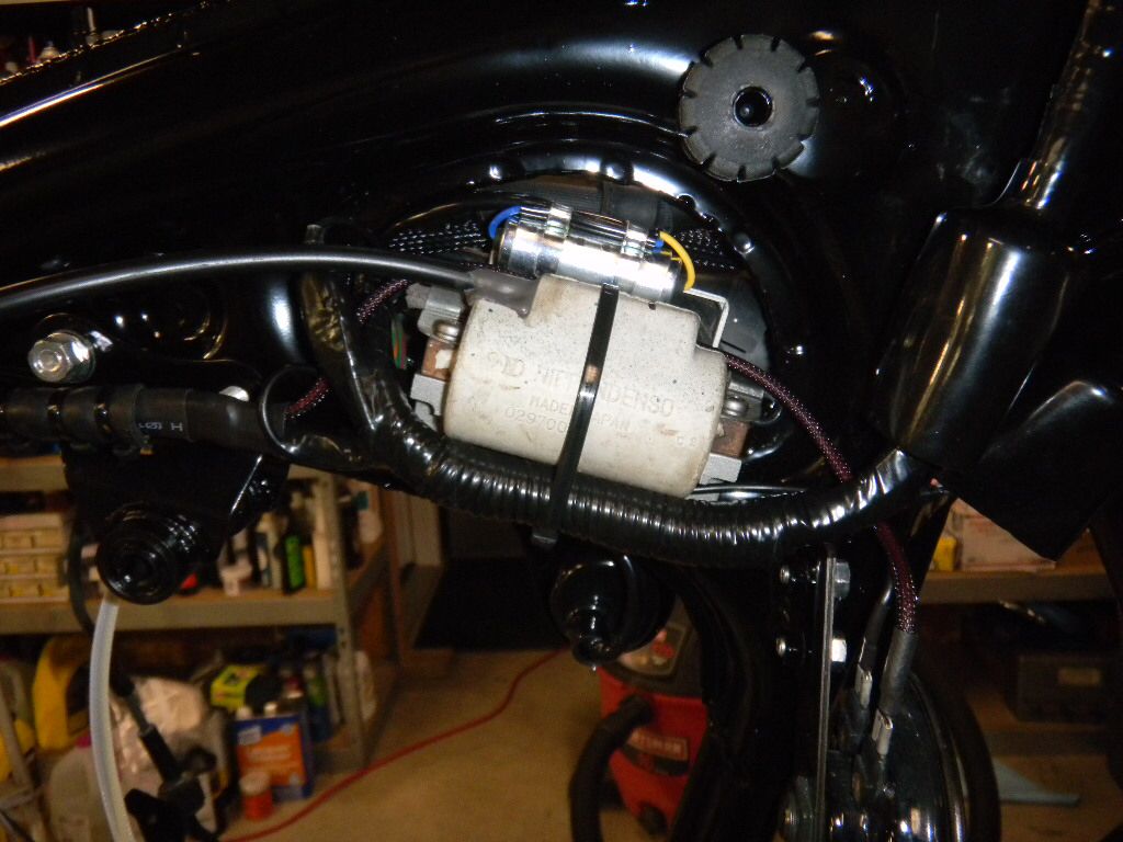

#56
LOL love all the little blue piece of tape. looks like something I would do. My brother would just wing it.
Looking cool Ray. Must truly be a labor of love.
#57
(03-21-2016, 11:05 PM)The ferret_imp Wrote: LOL love all the little blue piece of tape. looks like something I would do. My brother would just wing it.
Blue tape is a good friend (keeps me sane... or close to it)

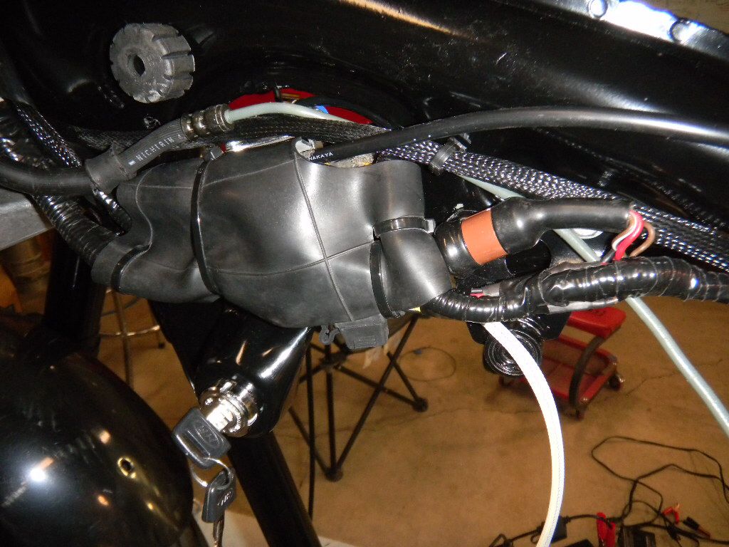

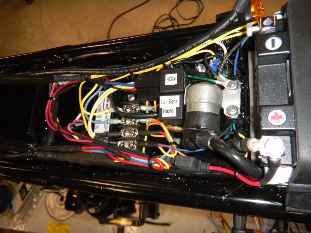

Update. I'm about 90% done with the electrical. Still need to do the stator, neutral light and tail light wiring.
Here's what it looks like under the seat.
[Image: 3f67a4c77c8e3115d0280ecc4c4f4b45.jpg]

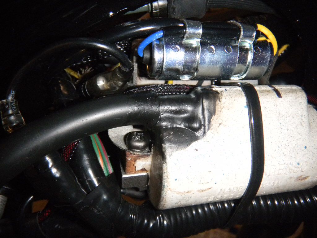

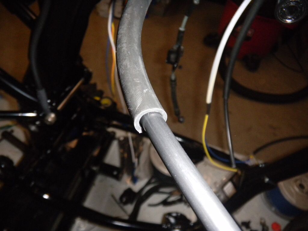

Got my hands on some black Tygon tubing and inserted it over the spark plug wires (similar to stock)
[Image: 097176301d9557c7ad4accc3bb5587d8.jpg]
Took some liquid electrical tape and adhered & sealed the top end. Amazing how well it works.
[Image: 57b604642dbb679a7441339fe03ab8dc.jpg]
