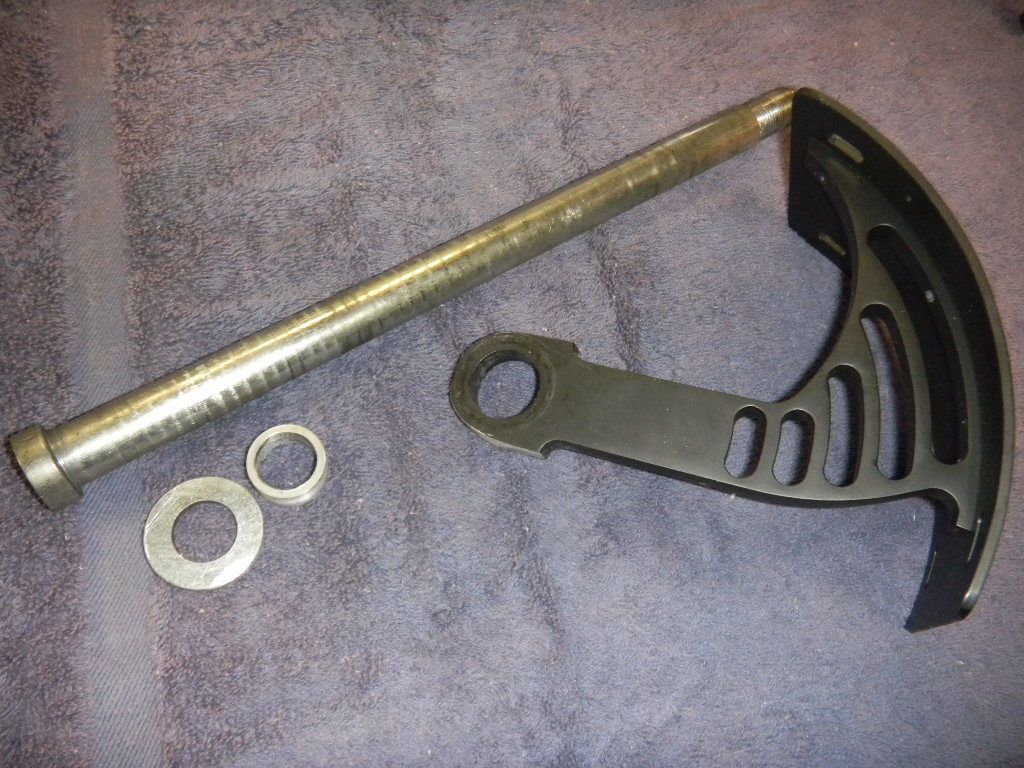

Been debating where to hang the license plate. First choice was underneath the tail light. I could do this, but it would be at such an angle that it wouldn't be visible from the rear. Next choice was a vertical mount.
Purchased a generic mount, machined a washer and bushing. Also, got a longer used shaft which needed to be cut down and rethreaded.
[Image: 04cbd563611f1cce1e0685fd764485df.jpg]
[Image: 976bfa4948451be2e6cc5f50973e2e1d.jpg]
[Image: a856b00debc31ad35fb6d8c059367cc6.jpg]

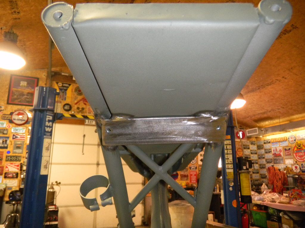

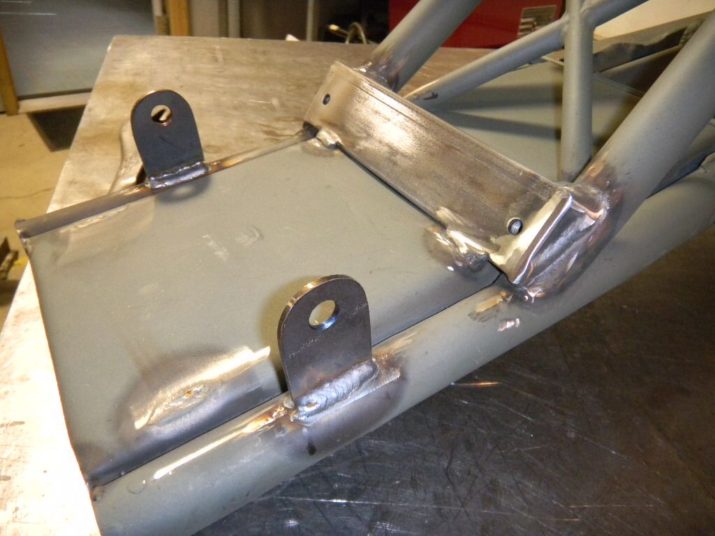

Sometimes I wonder if my head is screwed on. Forgot the battery hold down brackets. A little metal work, grinding & welding.
[Image: ce0b3a1d857458a46979575749b2f6b4.jpg]
[Image: c468a7b1ed2b2a97dc4dfd7796050a0c.jpg]

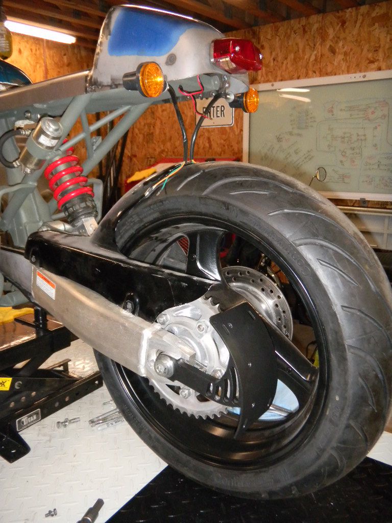

While I was at it; decided to relocate the turn signals to the frame vs the seat cowl. Boxed in the license plate bracket too.
[Image: e6f4b65065da486970a6556177ab5e66.jpg]

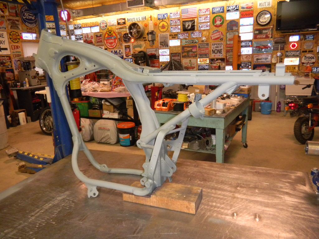

Sanded things down, and reprimed for painting (hopefully today)
[Image: 6d6eedaeac6d83307a21e5595097ce48.jpg]

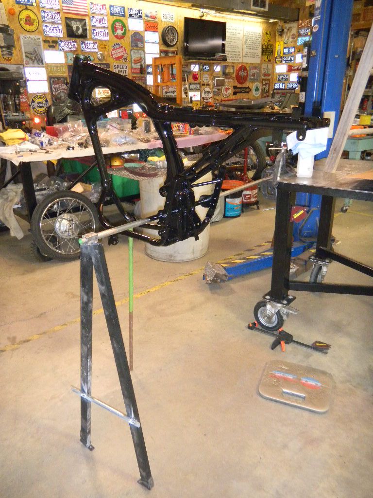

A bit of progress. Made a makeshift rotisserie. Painted the frame with about 1 1/2 cans of Rustoleum epoxy appliance paint. Went on well, looks good.
[Image: b58791b98ff0d6edb453f7374d5a3b6e.jpg]
