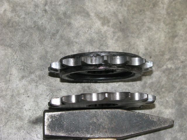

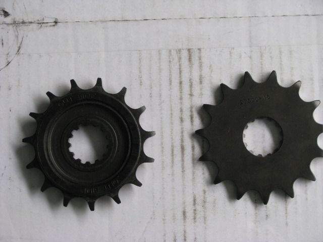

Edit: Thanks Gunftr, but I really prefer OEM, especially for the front sprockets. They're generally made of better materials, and they take little steps like these rubber noise-dampers that make a pretty huge difference IMO:
[Image: 4b08974a3f862a13b2d5d803e5002c3a.jpg]
[Image: b832a2b4690225bda28f3d61fb12a95e.jpg]
They have to comply with with EPA/Federal noise restrictions, so it makes sense they'd go through extra measures that the aftermarket doesn't even worry about.
