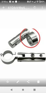

What remained to be solved was a way to mount these hoops to the side of the motorcycle in a correct and secure orientation, and extremely luckily I think these may be the ticket:
[attachment=1372]
(It's lucky that they made the genuine Honda rear rack with 7/8" tubing, since this means there's all kinds of accessory mounts for 7/8" handlebars that will fit it.)
I don't need the whole clamp as pictured above, just the hoop part that clamps around the 7/8 in tubing...
[attachment=1373]

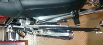

... and here's where they go:
[attachment=1374]
I'm pretty sure these clamps are in the right location so that I can just use a series of spacers and bolts to attach the hoops directly to them.
(I did a test holding up the side cases with my wife on the bike, and I think the position is correct, though spaces are tight given the exhaust pipes below and her legs above, so until everything is mounted and we actually take a ride, I may not know if my luck has held, or if instead it's take deep breaths and shuffle back to the drawing board.)
Once the hoops are attached to the rear rack via these two clamps, then I can determine what additional brackets I may need to make sure that the side cases are secure and aren't going anywhere when riding the bike.
