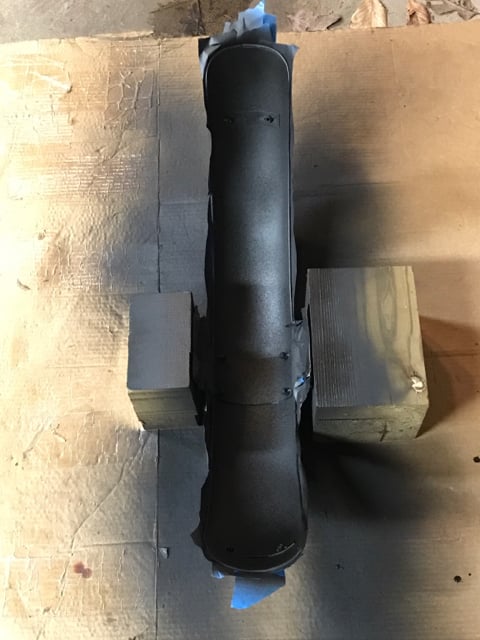

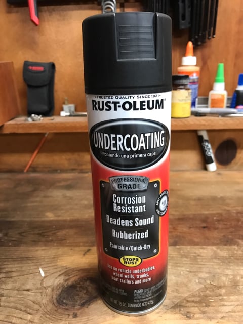

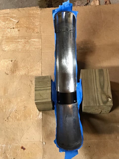

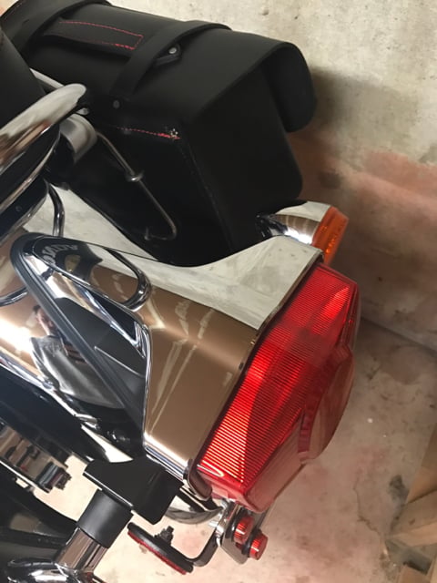

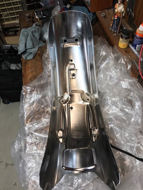

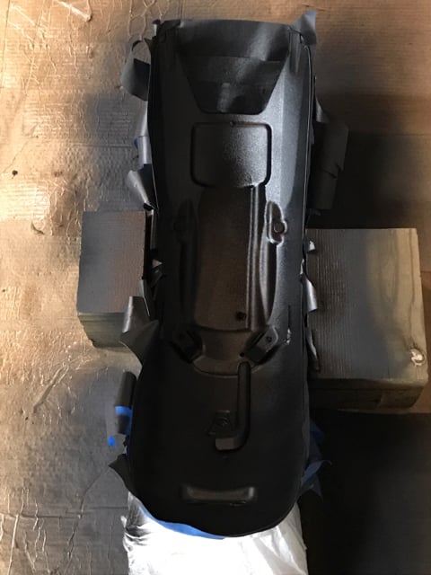

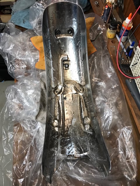

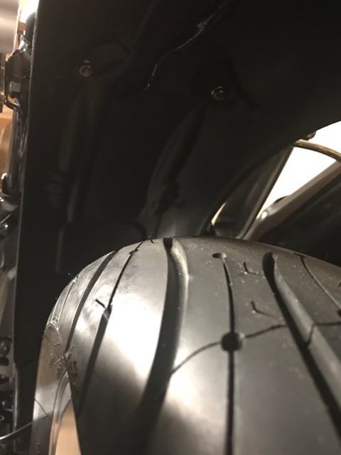

To be clear, it was Honda Lover who wrote the detailed description...I just followed his instructions.  And maybe borrowing Suhawk's idea of using POR15 instead of the Rust-Oleum Undercoating is a better idea.  The surface created by 4 coats of the undercoating can be compromised as I found out re-installing the rear fender, some small areas that I had to retouch after getting the fender back on.
But with you living in dryer Utah, perhaps it will never be an issue.  I don't ride in the rain on purpose, but it's almost inevitable to ride wet streets unless one limits riding to July - September...which I don't.
