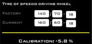

So, 140/70-18 vs. 160/60-18:
[attachment=1579]
The 160 is almost an inch wider, but height is the same for practical purposes.

Yes. I kept thinking the stock tyre was 10/80, but it isn't; it's 140/70, so the difference is. as you say, negligible.
thanks for the link to the calculator Ventueri. That's really helpful.

Actually, Kardis' brain is in better working condition than mine . :blush:
I now think it is correct that the speedo will be off.
What I failed to consider is that the 160 is meant to go on a wider rim, and so when you squeeze the tire onto the 140 rim, the tire will push the diameter outward.
