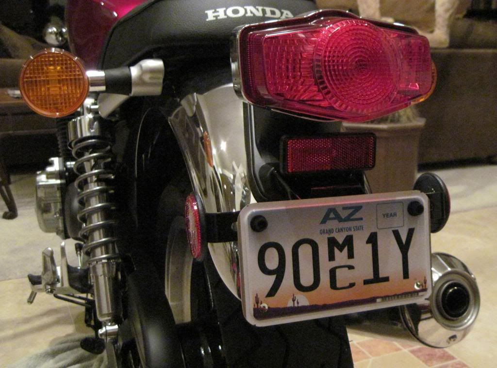

The designers of the CB1100 went to great lengths to make it a beautiful bike that incorporated many features of the early CB's. One of them are the cool chrome fenders. Unfortunately you can't see much of the rear one as it's completely covered by the ridiculously huge license plate bracket that is festooned with 3 reflectors, is far too wide, sticks way out from the fender, and has the license plate hanging down so low you can't even see the bottom of the rear fender. It's like a big wart on the tip of a beautiful girl's nose. I'm sure it satisfy's a lot of regulatory requirements but beauty is not one of them. So I fixed it with a simpler, lighter, and sturdier bracket I built myself and thought I'd post photos for other members who want to give their CB's a better looking butt. First, here's the original bracket.

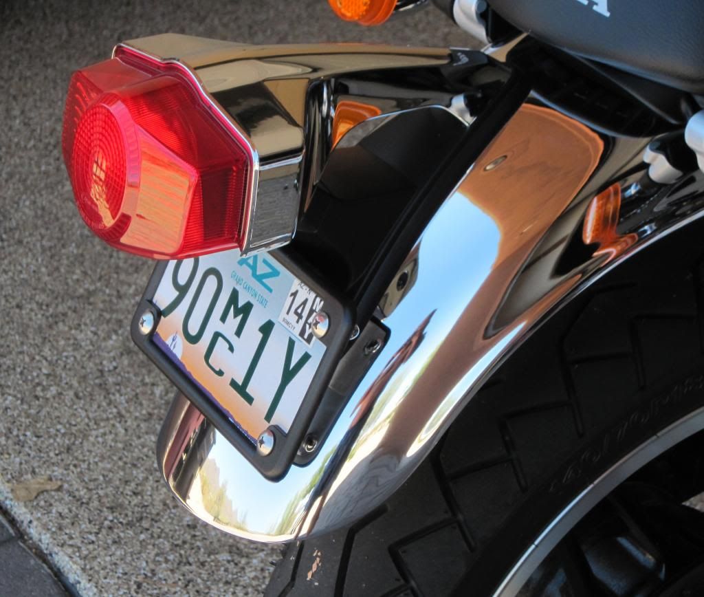

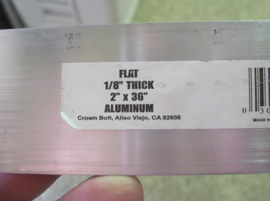

So, down to Home Depot for a strip of 2" wide, 1/8 inch thick aluminum and I cut a 6 1/2 inch piece off of the end. I then filed and sanded all of the edges smooth and sanded the entire surface to give it a brushed finish. After removing the original bracket there are two big round washers with a flat surface that provide a rock solid mounting point for my new compact bracket. Use a 1/4 inch bit to drill the holes and use a much bigger bit to countersink the holes that will attach the plate to the fender so the plate can lay flat against it. I used all stainless steel bolts, washers, and locking nuts so there will never be any corrosion. Drill the top of the plate with 2 non-countersunk 1/4 inch holes to attach the plate to. I tried both chrome and flat black license plate frames and I liked the flat black better but either would look fine. Stainless round Phillips head bolts with acorn nuts and lock washers secure the plate to the new flush mount. NOW....you can see the bottom of the rear fender, the plate is tucked up close to the fender and higher. The taillight illuminates the plate even better than before, the plate is much less obtrusive, and my CB1100 has a much prettier butt. You be the judge.
Total cost, about $10 for the strip of aluminum, $8 for my stainless hardware, $7 for the flat black license plate frame, and about 3 hours of my time. I really like the way it looks now. Cheers.
