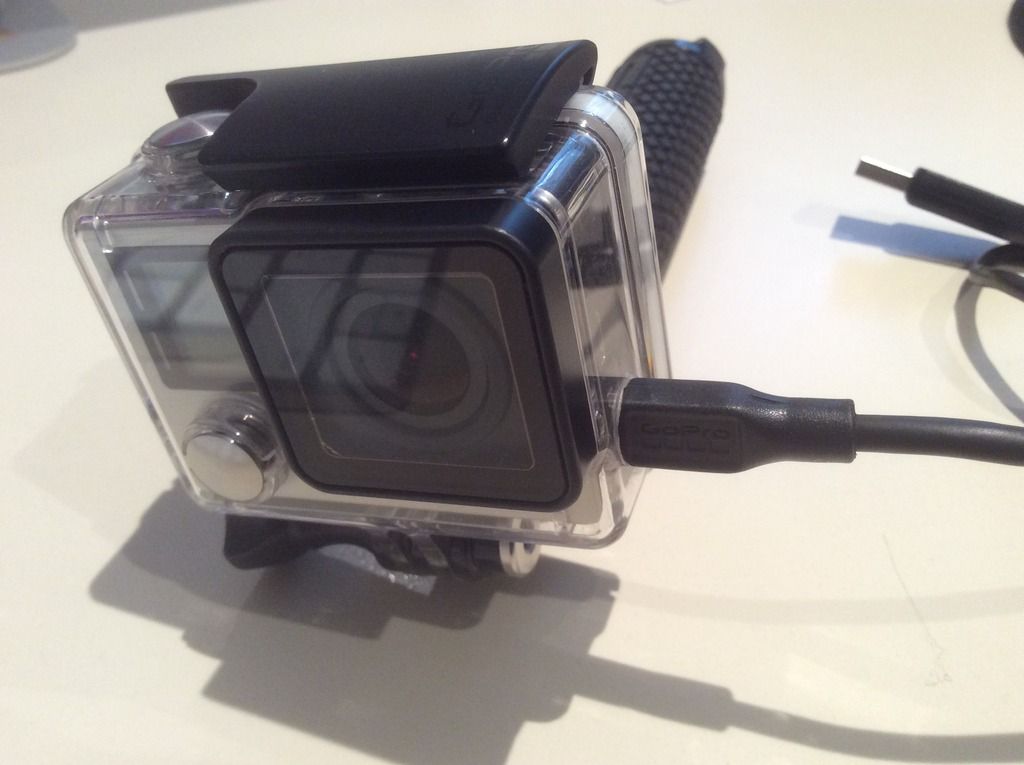

It is plugged into the Mini-USB input on the camera. More on that in a moment. A 1.5 meter M-M 3.5mm extension cord allows it to be positioned just about anywhere on the bike. Below is an example of it plugged to the camera on the bike fuel tank side. I am having some success placing the microphone on the pillion grab bars just above the muffler. At first I tried it with the wind cover but found that the cover also reduced the muffler sound. Without the cover it is much better, it just needs to be in a wind protected position. I want to try it put behind the screen I have fitted to my bike. Work in progress.
[Image: f81a1aa0a37e8a253f8fb1e230d20cc9.jpg]
To plug a microphone into the GoPro camera while in the waterproof case, irrespective of the back used, required some modification to the case. So, after some thought, I drilled a 10mm hole in the case, centred over the Mini-USB port. With a little bit of rounding off to the Mini-USB cord end it fitted so that it is water resistant and would keep light rain out.
[Image: 7b1ee6f5954c93a8666d719308c8a659.jpg]
When not in use I plugged the hole with a rubber blanking grommet that, despite coming in an imperial size, fitted the metric hole perfectly.

However, microphone aside, this modification gives another, and entirely unplanned, benefit. Battery life of the GoPro allows about two hours recording and shooting. This figure is rubbery as battery life depends on a number of factors. Two hours might seem enough and in most cases this is so, particularly if a spare battery is carried. But if you are touring and plan to ride six hours and then, say, camp out at a spot where a charger is not available, then you have a problem. Also some people like to use a "looping mode" where the camera operates continually up to its battery limit. This modification allows the camera to record and charge concurrently. Or just charge if required. This is good. It is done by connecting the charging cord to that same Mini-USB port. See this:
[Image: 810d65ef11663fad6ccbcf3627af22a1.jpg]
So this will give unlimited recording time as long as the USB charger is operating, plus two hours.
