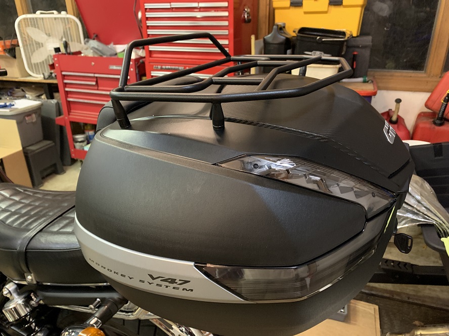

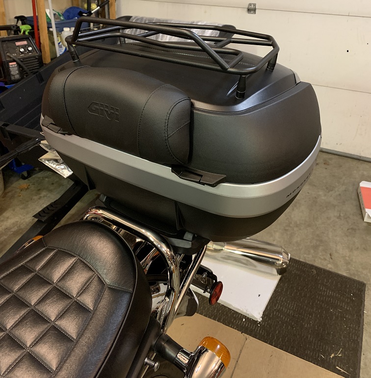

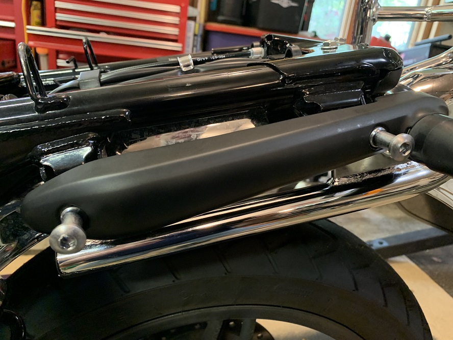

Mounting the rack was straightforward with a little jiggering to get it as straight as possible. I chose to have it sit back about 0.5” from being butt up against the rack riser (thinking to add some clearance for the backrest and preserve passenger room). The plate is a grate type structure, and you insert metal square plates with elongate slots (for adjustment) you thread bolts through that go past the chrome rack into the brackets and secured with locking nylon nuts. I snugged them well, but not too tight as the plate is plastic and I did not want it to distort or crack. It is actually a heavy weight thick ABS type plastic.
[Image: 32977304ee7072dec33cb7f4ee675d94.jpg]
The rating of this case is 10Kg (22 lbs). That was about what the previous one I had was rated too, but I think there is some margin in there, and I have easily carried at least that without worry. I wouldn’t want to put 50 lbs in there, but less due to concern the rack/trunk would fail as you probably just don’t want that much weight cantilevered off the back of the bike that could impact handling.
I also previously said “lights”, because the 47NN looks like it has them, but they are only lenses with ports that will let out light IF you install the optional LEDs inside the trunk. But, the generic mount does not have that built in spring-loaded connector that transfers the brake circuit to the inside of the trunk. I elected to forgo trying to fit something other than the generic mounting plate, plus it was a pain to splice into the brake light harness previously.
With the plate in place on the rack, it installs easily. It inserts into two forward hooks, and then snaps into place with the aft lock. One key (spare included) can unlock the case with the push of the upper button to pop the lid, or pushing the lower button releases it from the mounting plate. Then you can bring it in (your hotel room) if you want to with all the contents inside, or pop it off if you don’t need it for some sporting riding where it is unneeded (or just to make the bike look better). It looks pretty good without the case attached.
[Image: db0fcc7e26366643b3aa17348fbb4d74.jpg]
Attaching the rack to the trunk lid was a pain. That rack is a well made anodized aluminum piece and bolts to the lid after you drill four holes. A paper template is provided. No instructions, only pictures. It says to remove a bunch of stuff there is no need to (reviewers on line commented as such and that was true). It was a pain because the provided template taped to the lid appears to not line up with the rack four short legs that angle inward making the holes look too closely spaced. What you have to realize, and this was my fault, it has spacers you insert under the feet that are canted inward, that then makes the template holes be about right. Not realizing this caused me to have to remove the rack 10 times to ream the holes just enough, and fight the fasteners from the inside of the lid to line up without cross-threading. Once finally secured, it looks great. I could see attaching a dry bag with a lightweight tent and bedroll to that lid rack to preserve cargo capacity inside. The backrest was an easy 5 minute affair using the template, but those two bolts had markings inside the base, where the trunk rack did not. It would have made the whole affair of attaching the optional lid rack much easier if they had done the simple same thing on the lid with drill hole markings on the inside for the rack. It would have also allowed slightly undersizing the holes such that the bolts threaded through the lid plastic for additional water resistance, though it should not be an issue given the rubber grommets included with the fastener stackup.
[Image: 3d3025cf5168f95c5745b8d5ebd44906.jpg]
[Image: 25c4fcce4e7df30f065a37347d861231.jpg]
[Image: 7e2dae40739637ae745439e31d77883f.jpg]
[Image: 978e5aa3c2fbf4dd5e1d19ac286864b0.jpg]
[Image: 014a4e48ee4cbc40d7a44cf7ed2ccbf1.jpg]
Overall, I like the result and am looking forward to getting years of use from it. Considering the heavy chrome rack of good quality, mounting plate, trunk, and optional top rack and backrest, it seems like a good value for around $550. And it is not fugly as far as bulbous cases go.

Great job, Jambo. I've always wondered what a V47 looks like with the optional rack on top!
When I bought my CB, I transferred my Givi V47 to the Honda with the same rack that you just installed. Being able to click it off when I get to work and carry my stuff in was too convenient to give up. Mine has the silver trim on top, mainly because there was silver trim on the back of the BMW, so it blended well. That sort of carries over with the CB's silver side panels.
Keep an eye on the welds - from the used Givi chrome racks I've seen, that's where they start to rust first.
A few things that I modified on mine. Since the "taillights" are just colored plastic and don't do anything practical, I took the lenses out, and cut some pieces of 3M Scotchcal reflective tape to fit the insides of the lenses, and reinstalled them. I figure that they can at least be reflectors if they're not lights.
Also, I didn't like all of the wording printed around the band of silver trim, so I painted that over to make it look a bit cleaner, and not a rolling advertisement for itself.
Finally, I added a flexible LED strip along the bottom of the rear edge of the rack. It acts as an added brake light, and works with the box on or off, and flashes several times before going solid. When I added a Givi rack to my Bonneville, I did the same brake light setup.
With the V47 fully loaded, I definitely feel the weight high up on the back, but it's not scary. And, since I rarely need that much space, I kept my eye out for something smaller. I picked up a slightly used V40 a while back, and use that a lot more than the V47. Most days the biggest thing I haul to work is my lunch, but the V47 is great for weekend trips, taking work projects home, or when my wife tapes a shopping list to my helmet. The V40 is, I think, a little more on the fugly side - sorta looks like a round Weber barbecue on the back of the bike.

(08-27-2020, 09:32 AM)Cormanus_imp Wrote: Good write up indeed, Jambo. You could end up with an awful lot of weight out the back of the bike if you filled the trunk and had gear on the rack.
True, so that requires some common sense. The top rack would be good for a dry bag if camping you could put in a tent and ground pad as mentioned. I have a real nice REI 2-person (well...two really intimate people...really a 1.5) and ground roll. That might weigh 6-7 pounds, and then if you were say camping, have dual purpose lightweight gear in the trunk. If solo, I could also utilize the passenger seat for a couple more dry bags attached to the bungee tie-downs and trunk rack. I have done this before (not on the CB). If you have ever done m/c camping before, then it is all about weight anyway, so you have small burner and aluminum or titanium cookware, and most everything you bring can do multiple things, like tarp for under the tent, or rain shelter for you or the bike, etc. I likely would not put but maybe 30 lbs max on the rack. That is to say the rear BIKE rack.
I would never put something heavy on that trunk rack because it attaches to the lid. It is not flimsy though. Where you drill through the lid goes through a couple layers and it is like 3/16-1/4" thick. I would not be afraid to put 10 lbs on it. It could also be used to lash something that simply does not fit in the trunk, but is lightweight. A couple months ago I picked up a violin in a HSC off CL and just bungeed to the Valk backrest. That rack would have made it more convenient and secure. Something like that.
