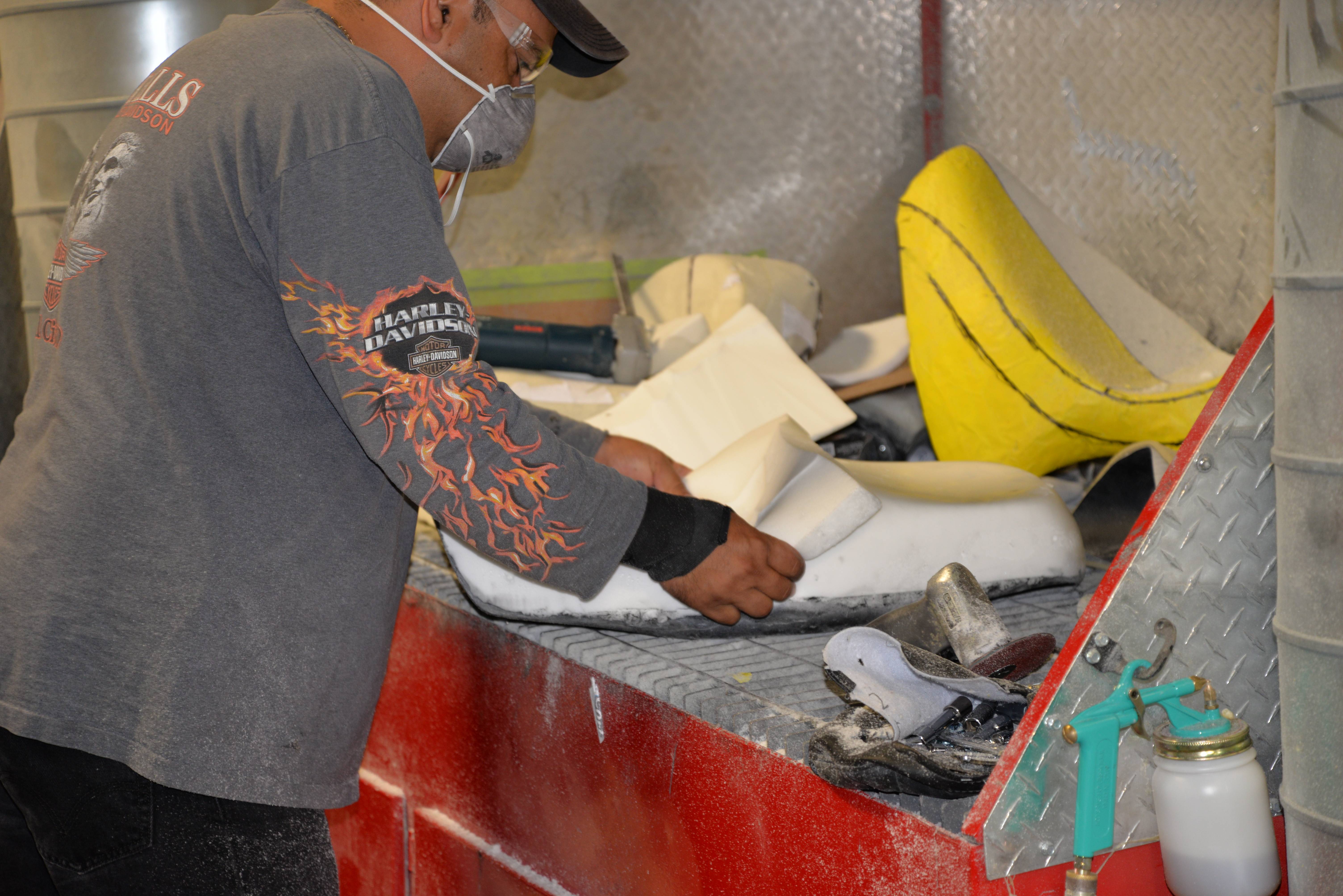

When I had Corbin make mine I had them add extra material at the rear of the seat pocket for the same reason....I felt like I was pushed too far back on the seat and it was going to cause me to be leaning on my wrists too hard.

Randy thanks very much for posting these pictures, i was under the impression the the gf/lady seats had a different shape and were not set so far back than mine.
Before i altered my seat i had a long think about what would happen and i put some towels on top of the seat to simulate the effect it would have on the riding position long before i took the leather cover off, after the alteration i can change the riding position by about two inches for and aft and get quite a different feel on the seat but the new position feels now very neutral and i don't slide forward or aft.
This modification seems to be requested a lot since they seem to know exactly what to do and do it very effectively, did you "test sit" the seat before it had the ( new ) cover fitted?
In no way do i criticize corbin, i like what they do but was disappointed with the way it worked for me, i watched all there is about their workshop and some more to get a thorough feel of how the seats work and are constructed and with so many different rider shapes they must have created their "norm".

I was on site and did a test ride before they installed the cover, and that was why I had them add the extra padding at the rear of the seat pocket.
