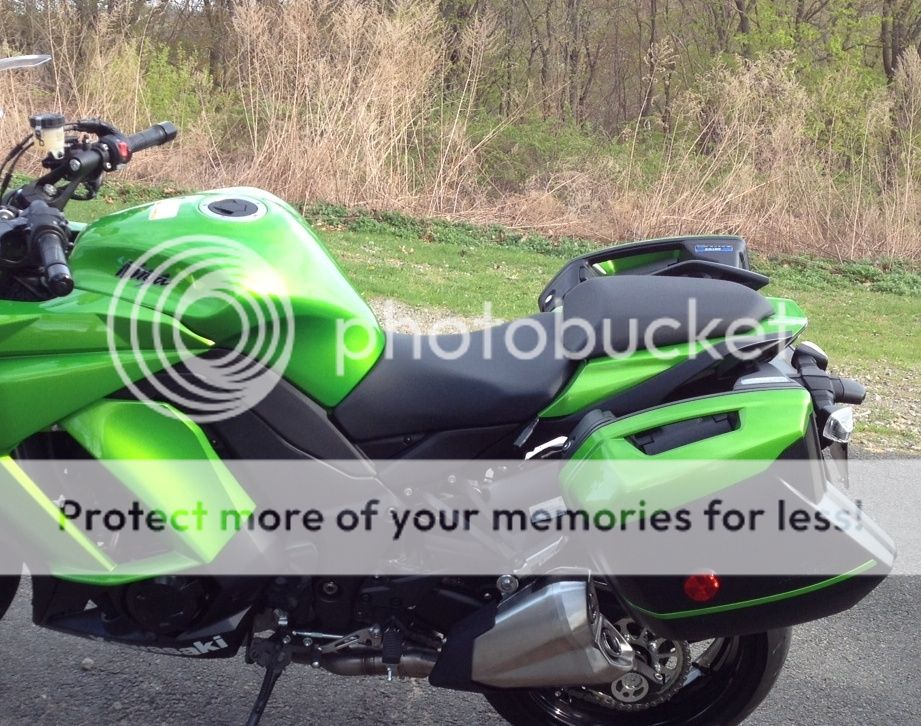

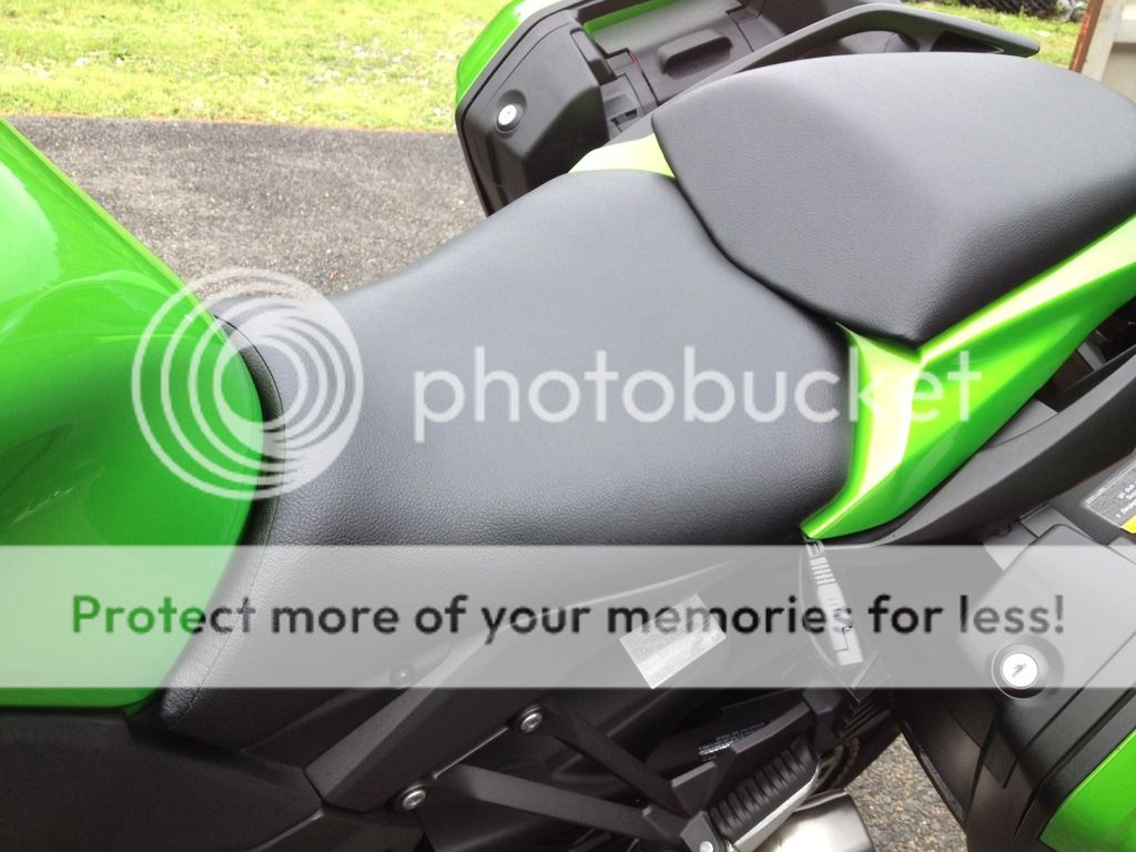

Picked up my seat this morning, Claude did a great job covering the seat and passenger to match. Used a Fuax Vinyl but shows as leather and looks much better than the cheap OEM cover. With the cover on the front seat is denser than the rear with memory. Push it in with your finger and it response slower than the stock foam. No more high spots, it fully contours with your butt. The seat is about 1" lower than stock which i wanted.

[url=http://s1034.photobucket.com/user/cipolla57/media/photo_zpsobrifbvz.jpg.html]
Stock
[url=http://s1034.photobucket.com/user/cipolla57/media/photo%201_zpsjxphakxm.jpg.html]

Well it came out nice. Looks like factory!

Its just so comfy just sitting on the bike. Contours perfectly, sits me forward just about 1/2 which I wanted and can just about flat foot with the 1 inch lower height. You also sit a bit more in the bike rather than on top.
