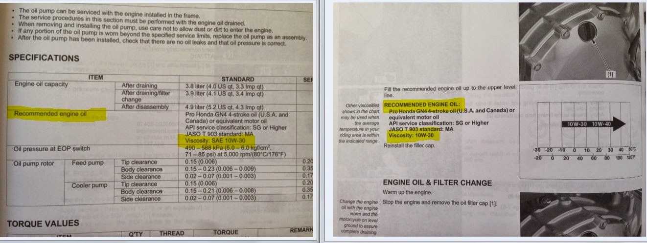

Service manual favors 10W-30 oil
Finally received my service manual, one of the things I looked up was recommended oil viscosity, since there has been much debate and I know my User Manual ONLY mentions 10W-30, others have said the service manual also recommends 10W-40....
But the way I am reading the service manual, I see recommended oil in 3 places ONLY mentioning 10W-30, only 1 place has a chart where in normal font says you "may" use other viscosities in the chart, in BOLD it still recommends the 10W-30.
Not starting an oil debate, just what I see in the user and service manual.

The SHOP manual CHART specifies other viscosities may be used in temp range -10 C and above. 10W-30 10W-40.
All auto and now motorcycle mfg are starting to recommend lower viscosities for the extra cold start protection and the better fuel economy.
I have used Mobil 1 synth 5W-20 in my Honda cars for years in the extreme heat of south Georgia summers and they have run flawlessly for years with no oil use. This is the oil that Honda recommends for these cars and with Honda's engine expertise I'll go along. Same goes for the CB1100. I'll use a good quality 10W-30 synth oil for motorcycles and leave it at that.
I think the shop manual charts are a generic reference of oils to the different temperatures.
But as HikerToo made reference to and my dealership checking on what our bikes specifically call for in the 1100 service manual it is referring to 30 weight oil. Now like my dealer said, they used the generic service info in their computer when they did the first service and did not reference the 1100 service manual to see if anything may be different. The generic service info gave them the qty of oil and since they only have 40 weight in bulk that is what they went with.

The big difference between oil viscosity requirements between cars and our bikes is cooling. In a liquid cooled engine the coolant does most of the work controlling combustion and cylinder head temperatures. In an air cooled engine the oil is responsible for carrying all that heat away from the cylinders. As a result, the oil in an air cooled engine sees a wider range of operating temperatures.
Back in the day when most bikes were air cooled, manuals typical recommended a heavier weight oil for hot temperatures, while liquid cooled engines can pretty much use the same viscosity year round. I suspect that's the purpose of the vague chart in the service manual showing 10w-40 at the higher temperature range. The manual for my CB750 goes as far as to recommend 20w-50 for temps over 100F.
