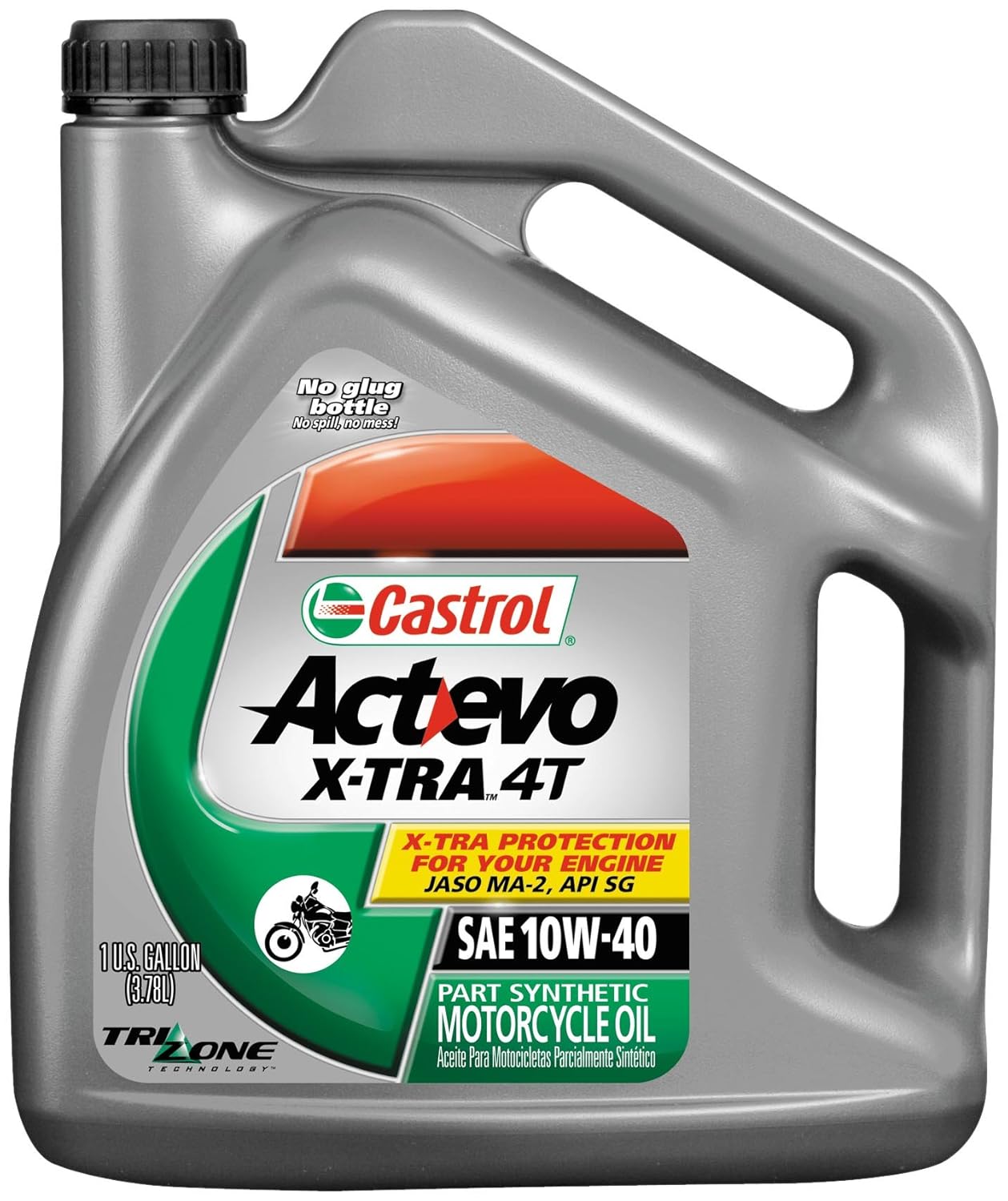

A wet clutch is one that is bathed in oil. Your clutch and transmission share oil with the engine and thus the clutch is what is called wet. A dry clutch is just that....dry. It is not bathed in oil.
What you are looking for on the container is JASO. That will indicate that it is designed for use with a wet clutch.
[Image: e66b04601f5d407dd1cec185a444680d.jpg]
If your oil was changed at a bike shop, likely an oil was used that will work with a wet clutch. Automotive oils that contain friction modifiers (most 0W-20, 30 oils) will cause clutch slippage. I would not worry any more about it.
