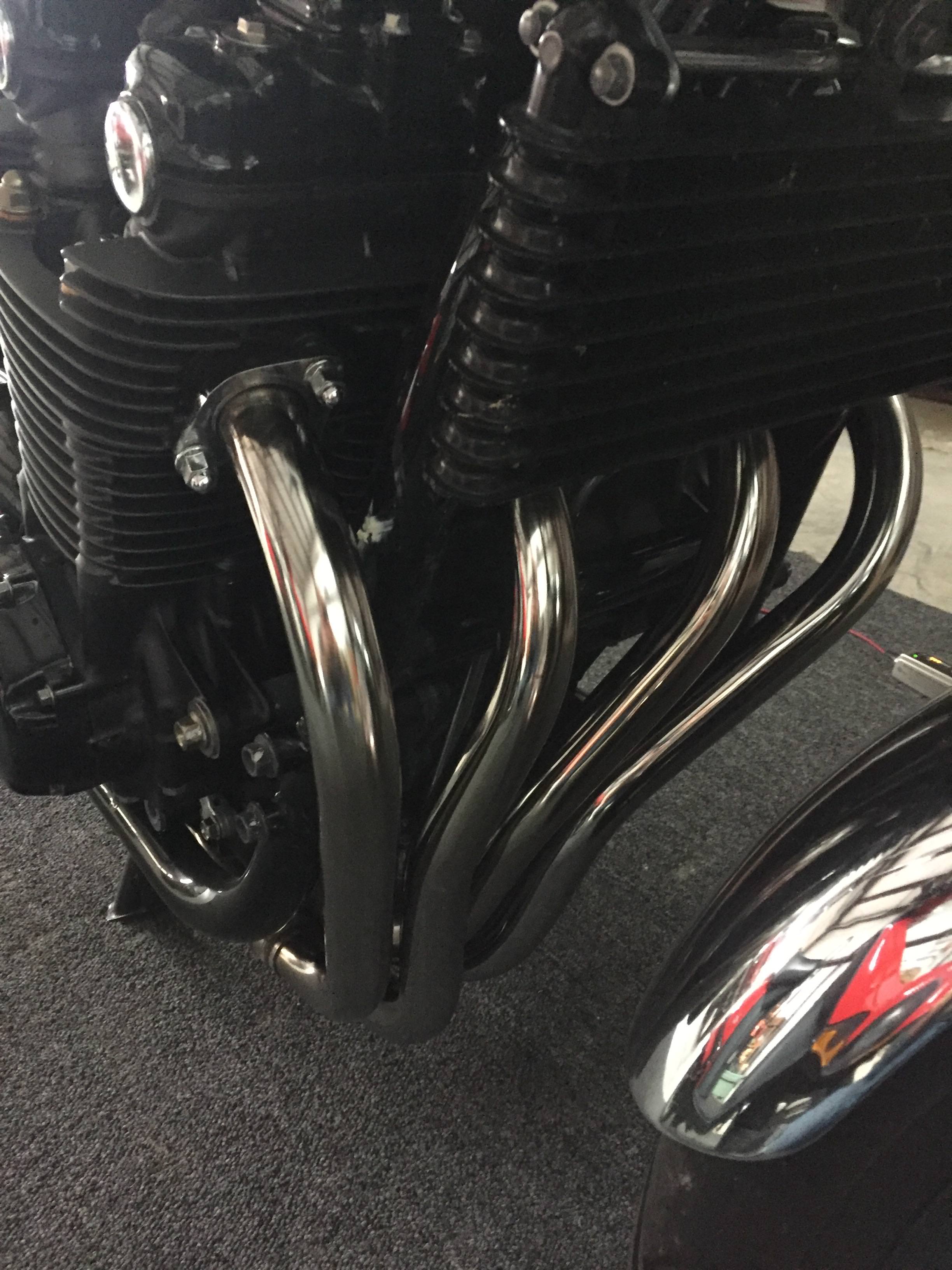

I tried autosol but that was not getting this layer off, so i started with 800 wet and ended up with 1200 wet sandpaper.
That cleared the stainless pipe, but to get it shiny i got some strips of cloth and wrapped once around the pipes and applied some autosol, just went back and forth with the cloth and worked it the length of the pipes.
[Image: 004d5e73f3277e2b384c022314409418.jpg]
and when all was done this was the result of one days work ;
[Image: 0910ac79a8a3aa2d4c981c1e6350cb93.jpg]
