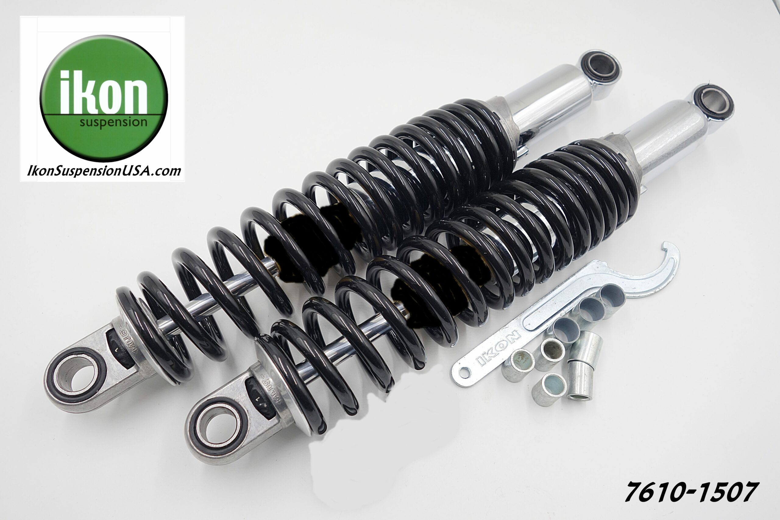

A low option for a dampening shock is Ikon (http://www.ikonsuspensionusa.com/shop/7610-1507/); starting at ~$400, they have adjustable rebound dampening, preload adjustment, and progressive springs, but aren't calibrated for rider weight and riding style.

I have IKONs on the rear of my 2014 CB1100 Deluxe. They work great! IMHO Cool

Just spoke with IKON . They have them in black for $400. or chrome for $460.
You can contact them at: ikonsuspensionusa.com. or call Dave Gardner at: 415-738-9441.
