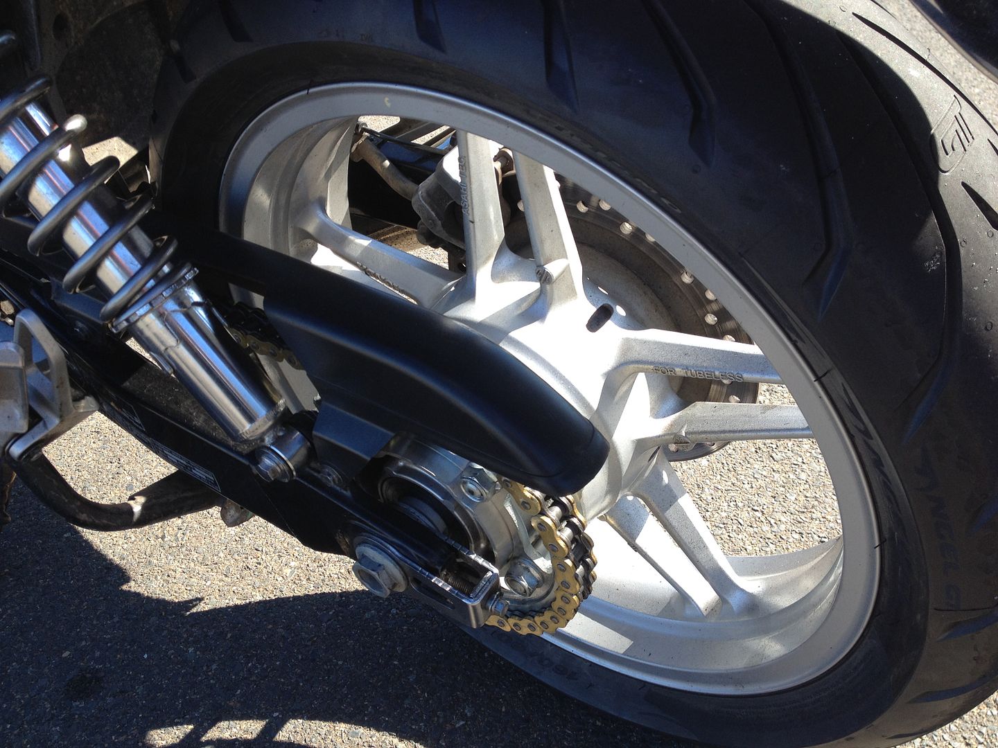

Finally Last Blast is on the road again (cue Willie Nelson). Initially I changed the [url=http://cb1100forum.com/forum/showthread.php?tid=6149&pid=95932#pid95932]sprockets and chain. Then what began as a simple tyre and front pad change became complicated when the front brake, after I reinstalled the front wheel, was a little spongy. I suspected a contaminated caliper piston seal. So off with the front calipers for a strip down and inspection. Two of the pistons did have slight scratches and I suspect that the right side lower piston seal was contaminated, probably by grit getting past the dust seal. It was difficult to remove and had a horizontal scratch past the oil seal. In any case, something had to be done. First I cleaned and then measured the pistons and calipers and found all to be in round and well within tolerances. I gently rubbed the scratches out of the pistons with jewellers grade wet and dry, ensuring I was keeping them in round and not making flat spots. I couldn't bring myself to change the pistons, the bush mechanic in me wouldn't let me. I ordered new seals (dust, oil and connecting) and caliper mounting bolts. It took time but finally they did get to me. I also stripped the front master cylinder down and found it to be all good.
Assembly was straight forward and I put new Dot 4 fluid into the system. I don't have a vacuum bleeder and didn't feel like forking out the hundred or so dollars for one. I started the bleed by attaching a good length of tube to the bleed nipples and vacuum bled by simply sucking on the tube. Of course, being careful not to ingest or swallow. It worked, priming the system and getting rid of most of the air. I then finished the bleed in the conventional manner, with a spanner, tube and bottle.
So with new tyres, sprockets, chain and brake pads I rode south from Sydney through the Royal National Park to Garie Beach. With new pads (sintered) and tyres I took it easy through the twisties and pulled up at Garie to admire the view and check that all was in order. About 60kms down and no leaking brake fluid, chain master link looking good, chain slack as set and all the bolts still tight. My initial impressions of the Pirellis was positive but as yet I hadn't gone near the edges. They are, however, a different tyre to the previous Michelin RP3s. Not better, or worse, but definitely different. How? Hard to say so more on that later when I have put some hard miles on them.

Within the hour I was back home and very happy with the work I had done. The tyres are good, but the bike has been transformed by the sprocket and chain replacement. Quiet transmission and no lash making for a "as new" ride. Smooth and quiet, really smooth and quiet. The difference was startling.
