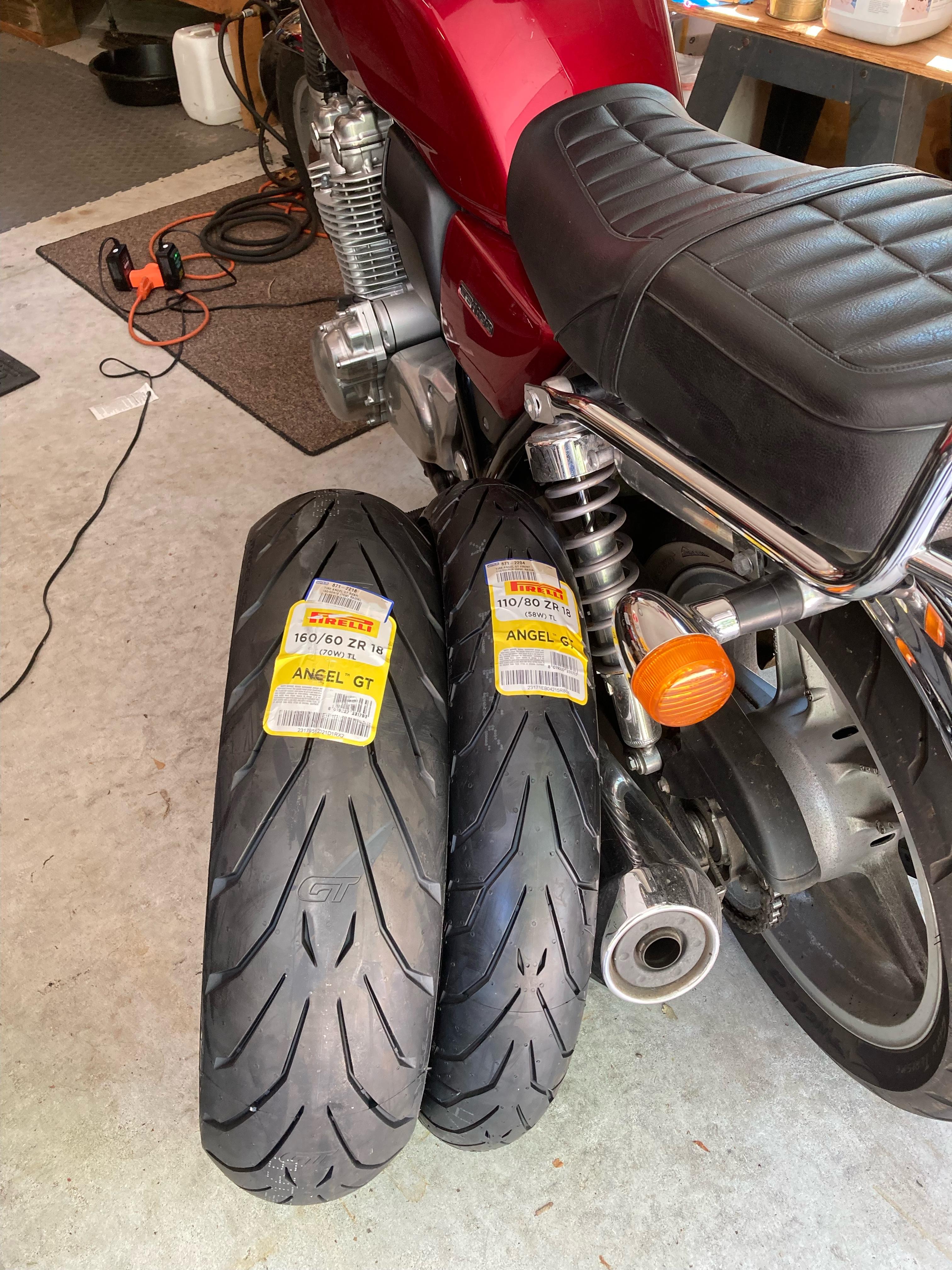

I use Pirelli Angel GT's in the 110 front 160 rear combination
[Image: 2f0f3e0b50ca57f4d55d908e3f3c1532.jpg]
^^+1^^ me too, 2nd set for my white CB.
Had Metzeler Z8 and decided to switch for Angel GT due to longevity.
(02-05-2024, 11:45 PM)The ferret_imp Wrote: I use Pirelli Angel GT's in the 110 front 160 rear combination
Consider adding a "d)" option, valkyrie_rider.
I'm happy with my Angels. Wearing nicely and offer great handling.
@Ferret & @Gone: this combo using Pirellis seems pretty interesting.
Can I ask:
a) How does it change the handling of the motorcycle?
b) How long do they last in general?
c) Does it change the reading of the speedometer/odometer?
Well the last set I put on about 3,000 miles ago at 71, 014. That replaced a set I put on at 60,510, so I got 10,504 miles out of them. The previous set I put on at 53,060 so I only got 7,450 miles out of that set, but I may have replaced them early due to an upcoming trip, I can't remember. Figure an average of 8-9,000 a set. The Michelin PR3s I used before that would go a little longer but Michelin discontinued our sizes.
Handling is great imo with the Pirellis.
have no idea if it changes the speedo/odo. I just ride the thing lol
