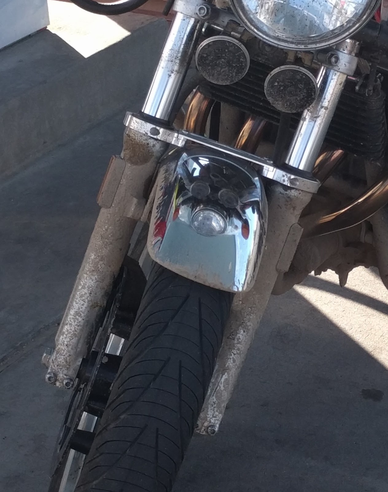

(04-04-2019, 10:53 AM)Cormanus_imp Wrote: Clean? What's that? Tongue
Slightly shinier than this?
[Image: d832d1f07874649898829e71247f1c3a.jpg]
That's how I like 'em, Flynrider. Thumbs Up
Even though I recall there was a bit of fork oil mixed in which is not so good.
Oh my! Is there a "CB Abuse Hotline"? I have a report to make!
[Image: 5baa6f3b2b23d9596b0884923a263748.jpg]
or this? ROFL
[Image: e179280d8dffedc8ea1d4d381aec3822.jpg]
