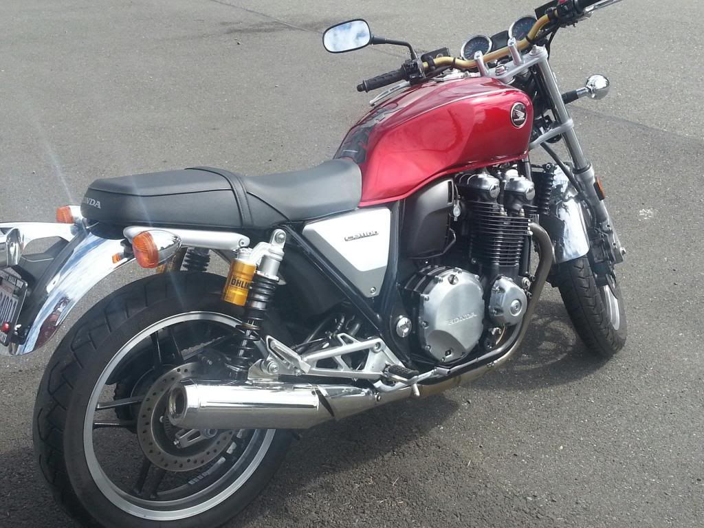

Ohlins Piggy-backs Installed
Mods almost complete:
-CB500f mirrors (These are great!)
-Staintune slip-on
-Renthal low bars
-License plate bracket mod
-Ohlins piggybacks: had to modify grab rails so they would fit.
[url=http://s742.photobucket.com/user/Mikey350D/media/CB_Olins.jpg.html][Image: 56f9a33655edc5078ca6c336aafbd149.jpg]

That looks great. A couple questions.
1. What did you have to do to the grab rails to clear the shocks?
2. Did those shocks need to have their stroke shortened?
3. Who built them for you and how much did they cost?

RE: Ohlins Piggy-backs Installed
Actually they were $1400ish.
I looked at several other brands, but decided to go with Ohlins quality.
Shocks were built by Pro Pilot (NJ)
I was VERY Very happy with their service.
I think they had to combine parts to create these shocks.
Price was $1440.
I have the lower clevis screwed all the way in,so they are OK but almost
too long.
The lower bushing is larger (16mm) than top, So Pro Pilot had to send me new lower bushings.
Drive side fit with no problems, but I did not like grab-rail bolt clearance, so I replaced it with normal socket head bolt.
(Annodized gold bolts on order)
The brake side was a clearance problem.
I had to carve out a half-moon underneath the forward grab-rail bolt.
Just used my Dewalt grinder and it looks OK from side/above.
(Can see if you look closely at photo)
For both rails I moved then in, up and back be doing the following:
-Wallered the bolt holes using mill end bit. This moved rails up and back 1/4"
-Ground down the bolt hole shoulder where rail mates to frame tabs.
This move rail in
Lessons learned:
I should have sent vendor more measurements: Shock length and stud diameters, But Pro Pilot was great about providing correct parts.
They are still too stiff, as I don't have sag dialed in yet.
Will do ride report when I get sag, Comp and rebound dialed in.
I really didn't need all the bells and whistles (rebound), But I really like the piggy-back look.

That is awesome!!! I want those a lot. Can you provide more pictures please?

Bad NewsAngry
I started to get a very slight rub on the brake side.
Not enough clearance between comp knob and grab rail.
Every looks OK when I'm off the bike, but under load...
So I'm going to play if safe and abandon stock grab rails,
get some new rear lights and fab new rails.
