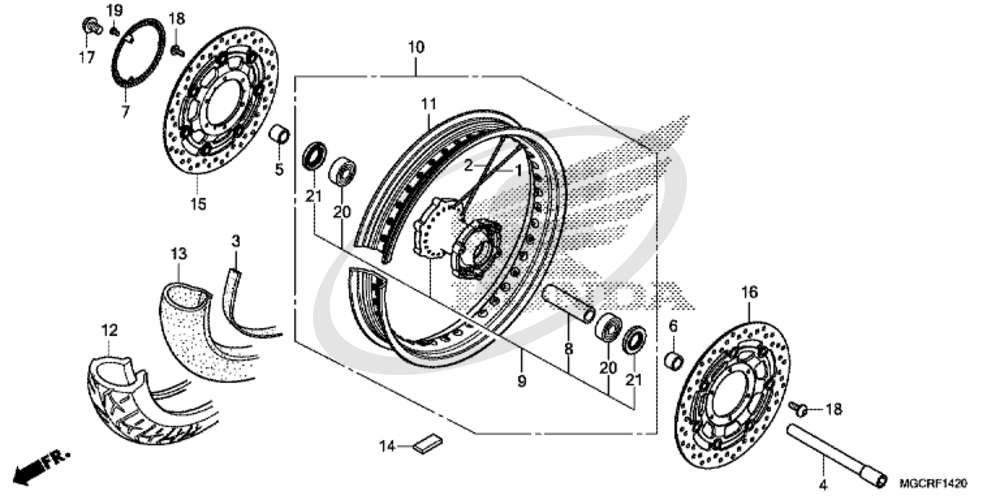

This is the front wheel exploded diagram for a 2018 CB (no 2019 is listed yet - edit, see below) from UK Honda parts supplier Fowlers (I think they all use the same, Honda-supplied parts fiche).
I cannot see anything that could be a "damper". The ring outboard of the disc is the 'pulser ring'.
[Image: 85383add4b8ff853b11b1ae6a5bd9db8.png]
I've just located a listing for 2019 parts and it is identical to this 2018 illustration.

That's the parts plan I've reproduced above. Initially it's a 2018 model, but then I found one for 2019 (yours, coincidentally!) and they're identical. There is no indication of any flexible insert whatsoever.
