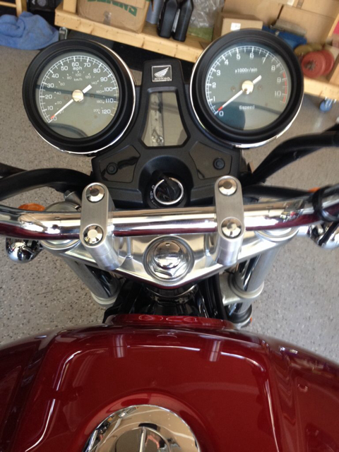

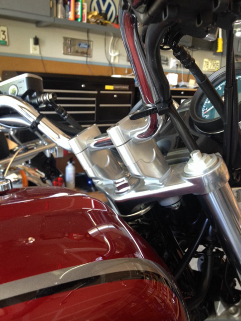

I have the GenMar 1" risers on my 14 Deluxe with no issues.
http://www.genmarmfg.com/shop/universal-...etail.html
Here's some pictures
[Image: ce9242c87a1a9f1eb68655a93c991593.jpg]
[Image: 15e44e18e4a2ea22ecf876e610bfb66d.jpg]
[Image: 27734aa88322f7fbcbe49f30716cdebd.jpg]
