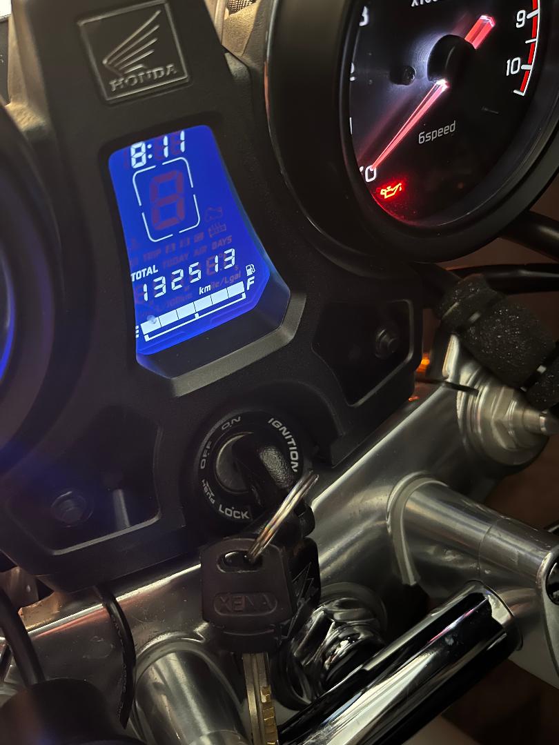

MR, you really surprised me with the heated grip icon on the dashboard.
I took a photo of the dashboard from a different angle and I must admit that it is there, but it does not light up (the bike is not running/the ignition is ON)
![[Image: 5fe1cd6242c915ffd6788a6332577382.jpg]](https://cb1100forum.net/forum/uploads/imp/202502/5fe1cd6242c915ffd6788a6332577382.jpg)
magnify pic to see
2014 STD
I do not know if this issue is related to this sub-harness that has not been istalled?
I will examine the dealer-installed OEM heated grips in the spring.
I do everything myself except installing tires and h/grips.

Thanks for the information. The light does not come on when the heated grips are on, only when you turn the key and the gauges/dash zero/reset.

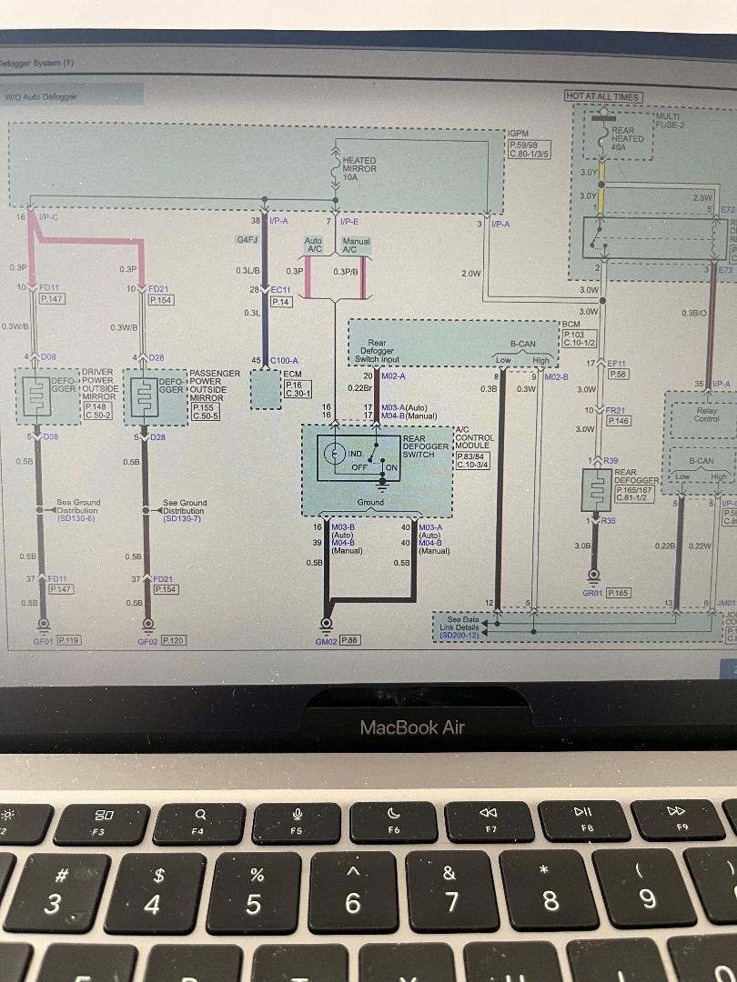

Honda doesn't provide any wiring diagram when it comes to the heated grips and dash icon.
Shame on Honda!
We could read from the diagram to find out how it is connected.

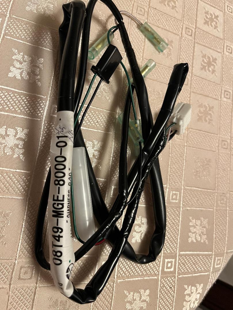

I paid for both sub harnesses for my std and dlx, see bill.
Have one that wasn't installed in my dlx, see pic
I'm not sure if it was installed in my std, I'll check in spring.

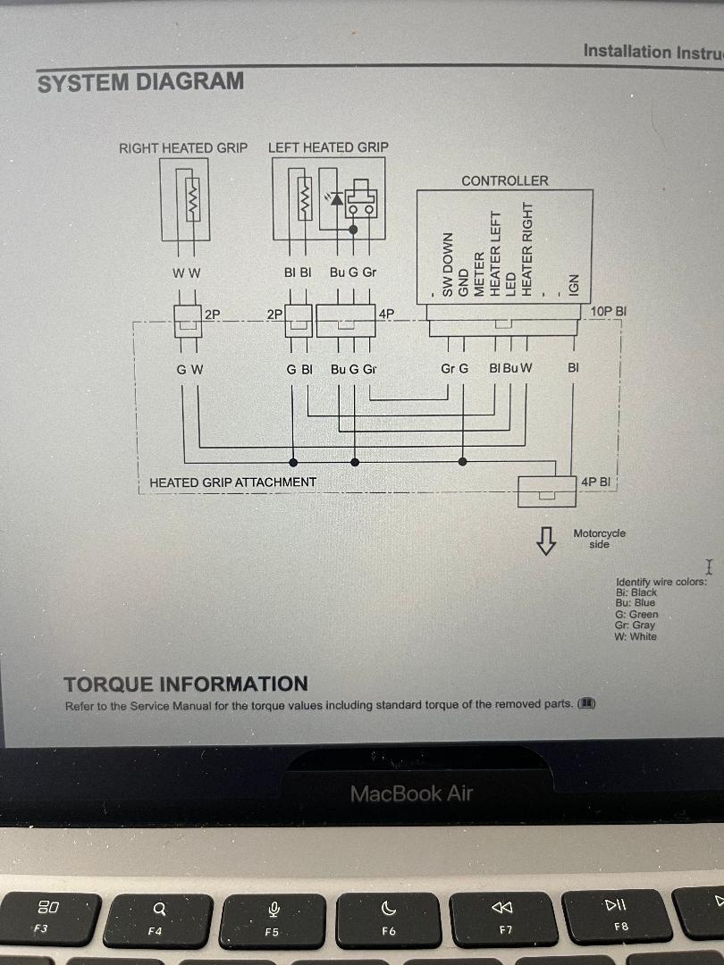

[url=http://cb1100forum.com/forum/showthread.php?tid=10160&page=2]http://cb1100forum.com/forum/showthread....160&page=2
Here is some kindergarten diagram for CFR300, and the grip icon is left blind
Here is a professional look of a real electrical diagram: pin location/male-female and numbering, power supply, grounds and all connections:

Yes, we already have a red indicator in the left h/grip.
