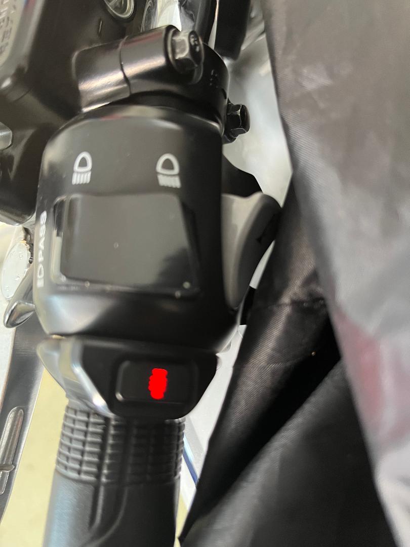

My OEM h/grip has a single readout red indicator with 3 settings, 1 flash = min, 2 flashes = mid, 3 flashes = max, and after each flash it stays lit which means it's ON and working.

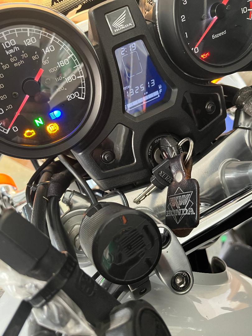

RE: Help identifing hand warmer setup - peterbaron - 02-07-2025
Based on my pics and experience, you have OEM heated grips:
[Image: 368d01cb77c9ecbe8f4616c1fef69595.jpg]
[Image: c4d72eaa0873fea520e1a9498238318a.jpg]
As to the dash/cluster gear shifter indicator > N <, I think this is what you are now talking about...??
Two different circuits and purpuse Smile

That's the OEM heated grip set, and the top part missing has the button to push the little switch button that turns it on and changes temp range.
That part is was never available separately from Honda.
The grip kit, which fits other Hondas, does not include the specific harness for your bike, is P/N 08T71-MKK-D02, and goes for around $225.00

Thank you both for the help! Yea I kinda figured I'd be biting the bullet so to speak on just being able to purchase a cover. I am going to try to make something to cover it and keep the moisture out.
I'm glad at least it is the OEM heated grip set so its quality!
Also PB I will take a picture of my dash/indicator/whatever (THE SCREEN IN THE MIDDLE LOL) this weekend because its definitely not the Neutral indicator.
