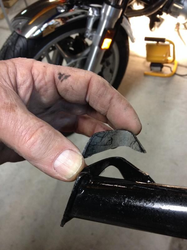

After fitting the pads and new tyres I was concerned with the clearance between the rear tyre (now 160/60) and the right side foot of the centerstand. With the 140/70 standard tyre the clearance is approximately 12.5mm (.5in). This was now reduced to about 7mm. Probably enough. But not enough to remove images in my overactive imagination of the rear tyre, at high speed, contacting the centerstand and bringing it down. Could be nasty. I thought about bending the right side of the stand out. There is not a lot of length between the foot and centerstand cross brace so a substantial bend would be required over a short distance. I then decided to remove the centerstand and cut the inside of the foot down to achieve at least a 12mm clearance.
Foot after surgery and a squirt of Kill-rust black paint.
[url=http://s847.photobucket.com/user/tonys_mail/media/tonys_mail/Fitting%20Michelins/IMG_0397_zpsbb097e98.jpg.html][Image: 3b6c62691f1ad59aa168900292163f1a.jpg]
Centerstand back in place. The clearance is now about 17mm. Imagination now at rest.
