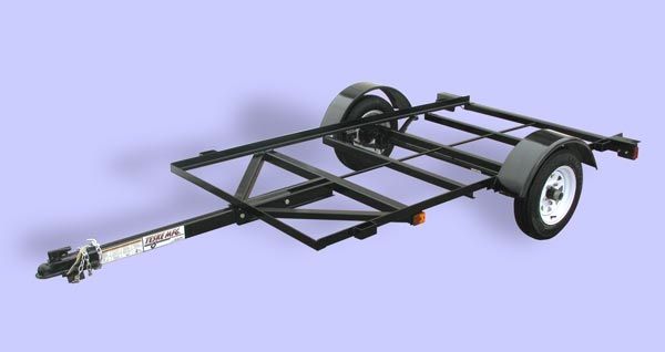

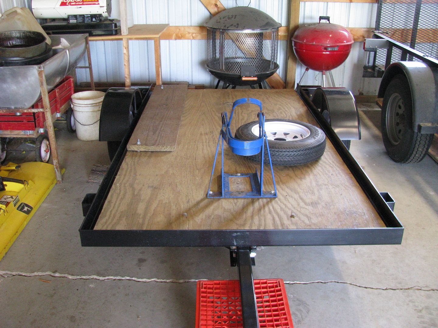

I use a 4X8 trailer for my bikes. $400 it came like this:
[Image: 781f3fd539a1ede434e762df7905eac4.jpg]
[Image: 478a5b3db1b9bac0af1b272ce32fe736.jpg]
[Image: a48b7603cecbc439fdc71a7844db9160.jpg]

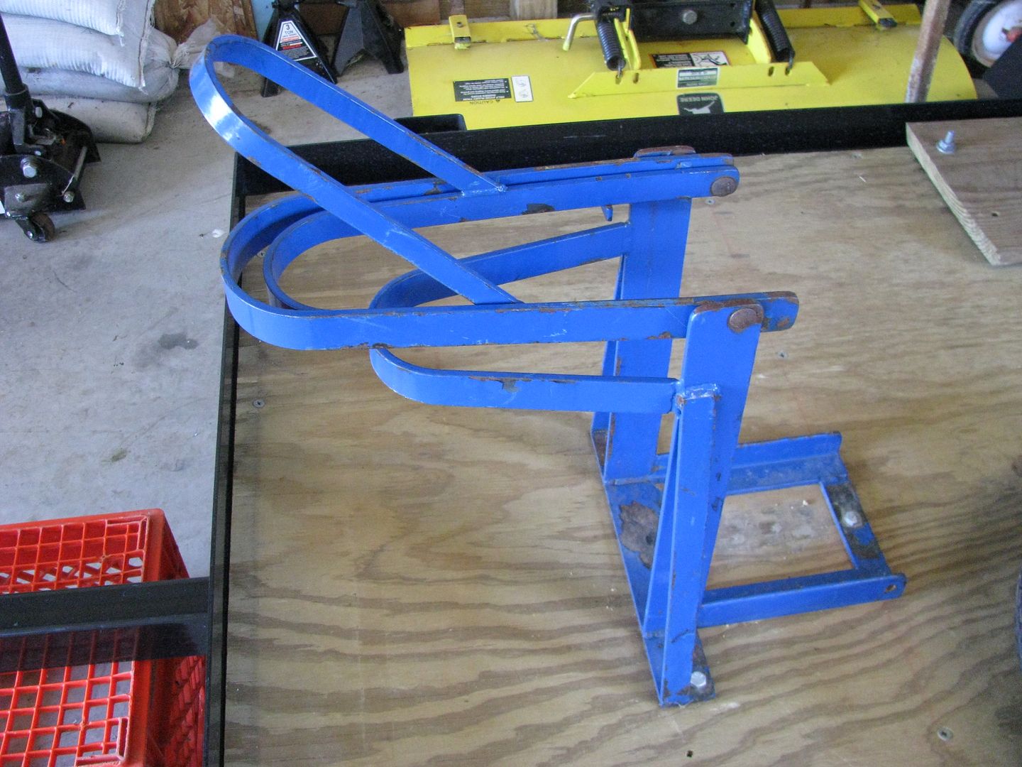

I paid $66 for a 3/4" sheet of plywood and about $12 in deck screws from Fastenal. $25 for a dirt bike chock on Craigslist:
[Image: 02ad7ff1bc8256ae91a5b1c2725c608c.jpg]

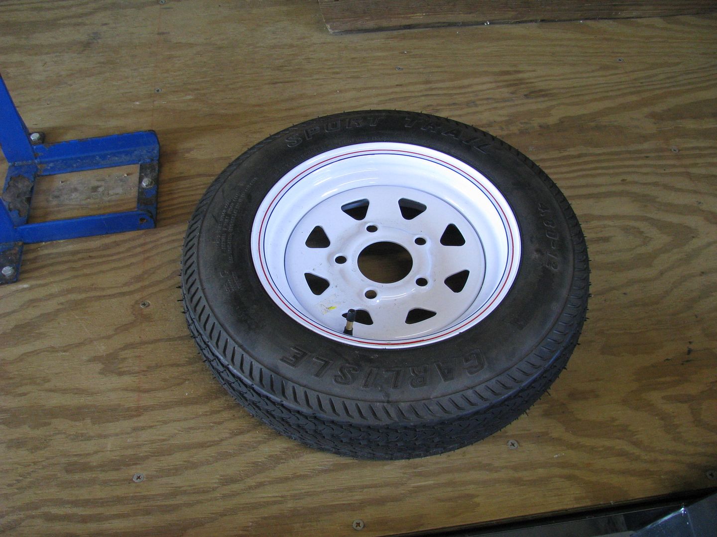

$60 for a mounted spare tire:
[Image: 3697abf8030c58a0b584bcebee07e99d.jpg]
Worked great hauling a dirt bike to and from and all around Colorado. I just picked up a new in box Condor wheel chock from a co worker for $75.
I welded a piece of angle iron on the back to set my Doug Fir 2X12 ramp on.
[Image: 05cb4ef99cc3241a7febdfd551f55bc6.jpg]
[Image: b867b77d1e39f242a62971a36112fdb4.jpg]
[Image: e8bf1f74e57b96b00784c83f194bb051.jpg]

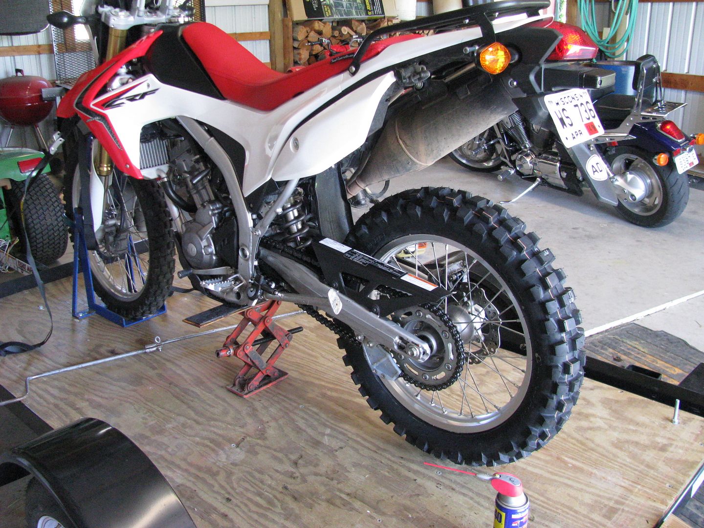

My four banger Tacoma pulls it with ease. Makes for a good work stand also.
[Image: 6e9d36a9e2d819f330dac3d713a5d696.jpg]
[Image: c2a69b28771b6ae604a726e6b0645bb7.jpg]
I have a bigger trailer for firewood, landscaping, etc. but this little one works great for bikes. It doesnt have that small of a "footprint" but my shed is big enough to keep it out of the elements
One thing I did do when I got it home when new? I pulled the wheels off, and checked the bearings, and packed them full with a real good bearing grease. I did not trust what the manufacturer had put in there. And bearing buddies helps keep your bearings in good shape easy. Dont be afraid of 12" wheels as long as you keep up with tire inflation and bearing checks you will be fine.

Teske trailers are built in Southern Minnesota. I bought mine at Farm and Fleet in Janesville, WI.

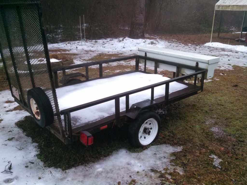

I like Ole's trailer. I don't have a wheel chock on mine yet, as I mentioned I just used a couple of 2x4's screwed down to support the front wheel. I ran out and took a pic, but it's still rainy and some snow left around here.

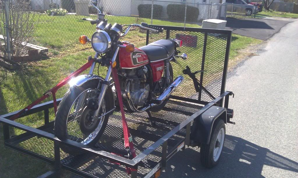

I also chose to go with a small utility trailer. tractor Supply had a sale and I bought a drop ramp model with 8" tires to haul my lawn tractor. When the bikes returned to the garage I upgraded to 12" tires an a plywood deck. This spring I plan to add tie down points and a wheel chock up frt. I don't think I have more than $500 total invested in it.
