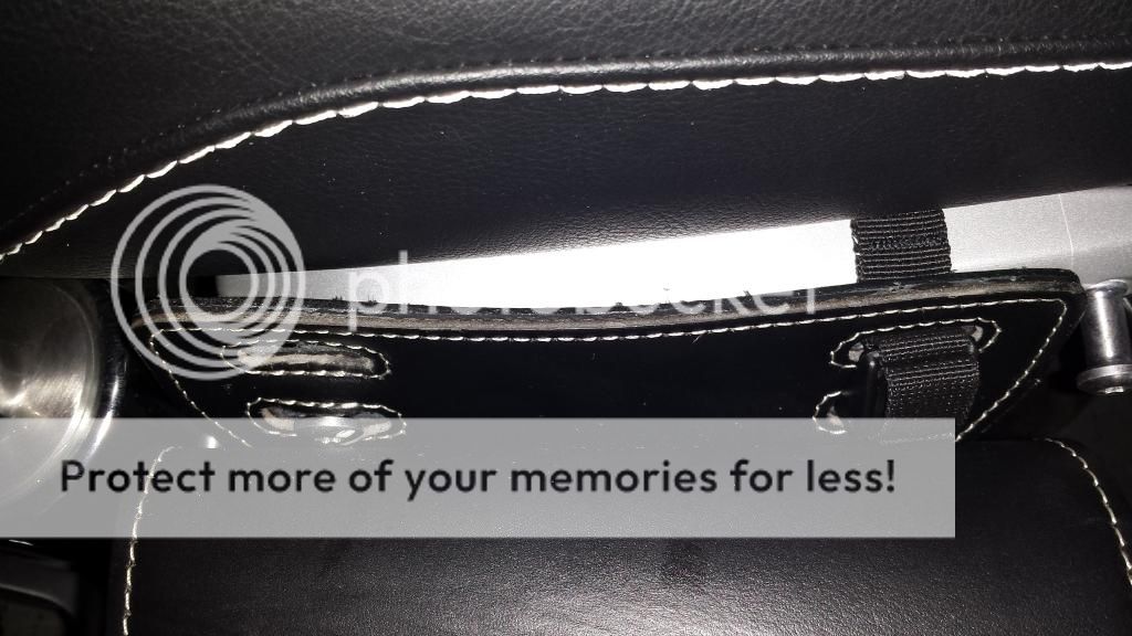

I wanted to post an update to my installation of the saddlebag. I wasn't totally happy with how it fit. You will see in the photo below a couple inch gap below the turn signal which looked a little sloppy. Also, the back side has d-rings riveted to the bottom corners and a couple of lashing straps are provided. With my saddle back support bracket, those d-rings were about 4 inches below the bracket, so the bag still wanted to sling off to the side and bounce around. Here's how it looked before:
[url=http://s960.photobucket.com/user/Pflugerville_Bike_Guy/media/20141220_160837_zps47bb0714.jpg.html][Image: a28783916b04dd7ab3a60644212e6a57.jpg]
First thing I did was move the front mount that uses the bungee peg from the upper slot in the leather tab to the lower slot. The leather strap I was using on the rear set of mounting slots was too thick to pass it out from the bottom slot and back in through the top slot, so I had to run it up over the top of the leather tab. That and having a buckle and wide spacing on the buckle holes kept me from getting a nice tight draw on the strap. I substituted a nylon strap instead.
[url=http://s960.photobucket.com/user/Pflugerville_Bike_Guy/media/20141227_212219_zps3ab5a475.jpg.html][Image: 19c63f7e7e67203f65c42100f3d4097b.jpg]
Next, I had to do something about securing the back side of the bag to the support bracket. The rear of the bag is reinforced with a thick plastic sheet, so I originally planned to drill holes and bolt some sort of homemade bracket around the supports. I stopped in to a Northern Tool store and found a nifty rivet gun designed for threaded rivets. It's just a steel threaded plug and the run has a threaded tip that you thread the plug onto and insert it into the hole and a squeeze of the gun mushrooms the plug to stay in the hole. Then, for a bracket, I had some little J bend brackets made for attaching bungee to a bicycle. They fit the support bracket perfectly, so I installed a pair and they fit beautifully:
[url=http://s960.photobucket.com/user/Pflugerville_Bike_Guy/media/20141227_212120_zpsd983420c.jpg.html][Image: 6fb8b5d031b077d37626f24e5ce017b3.jpg]
The result, a tightly mounted bag that hugs the turn signal as it was intended:
[url=http://s960.photobucket.com/user/Pflugerville_Bike_Guy/media/20141227_212021_zps1a18deb2.jpg.html][Image: bfd2aa5f3b20219416cdd3ff18690937.jpg]
