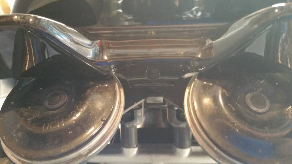

I went back and did a bit more trimming to clear the horns. Turns out I was pressing up against them making them sound funny. Now I have a little extra clearance at the gauges.

you dont need to trim at the horns. just loosen the nut, take a channel locks and bend the horn bracket tab down (not the whole bracket, but just the part that doesnt allow the horns to be rotated down, you'll see) then rotate the horns down a bit and tighten the nut back down.
this tab
not sure if you can tell but my horns are closer together than yours...
and now that im looking at it i need to adjust mine because theyre a bit crooked....

I like having the horns tucked in and less visible. I did bend the brackets back slightly before getting serious about trimming.
