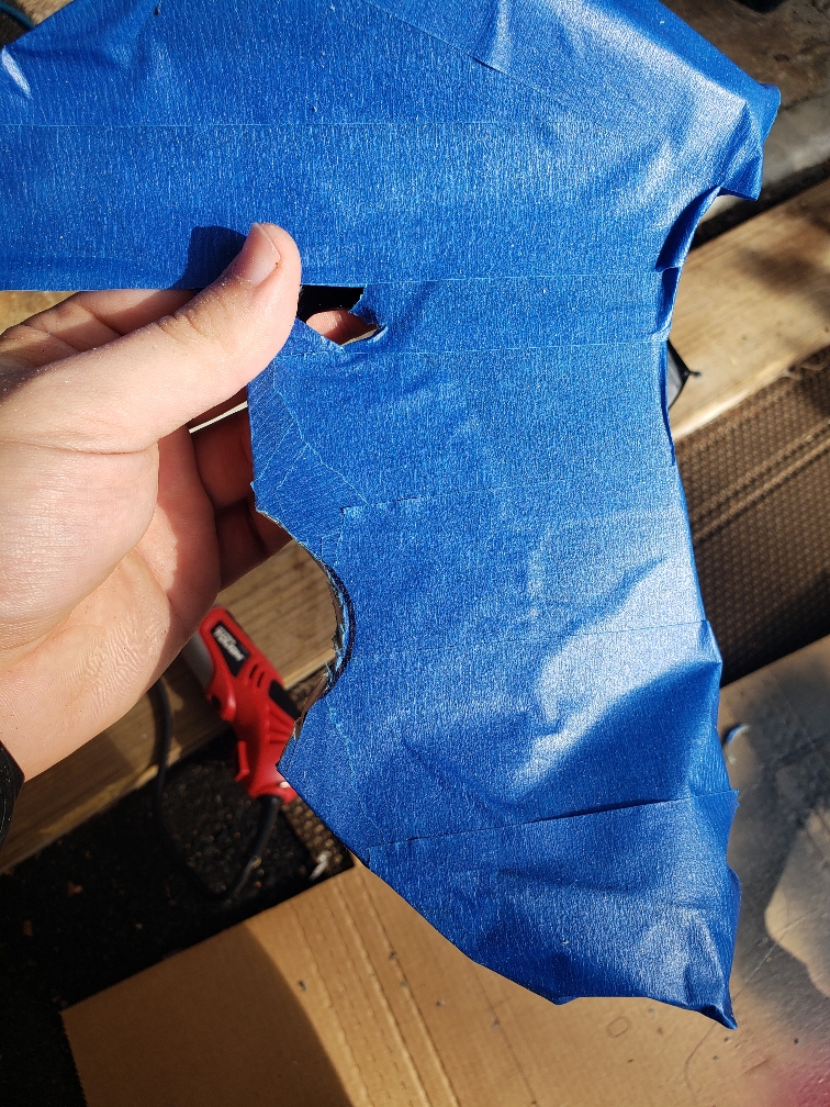

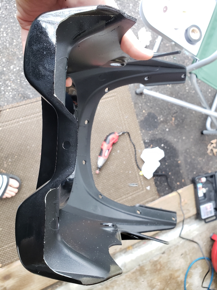

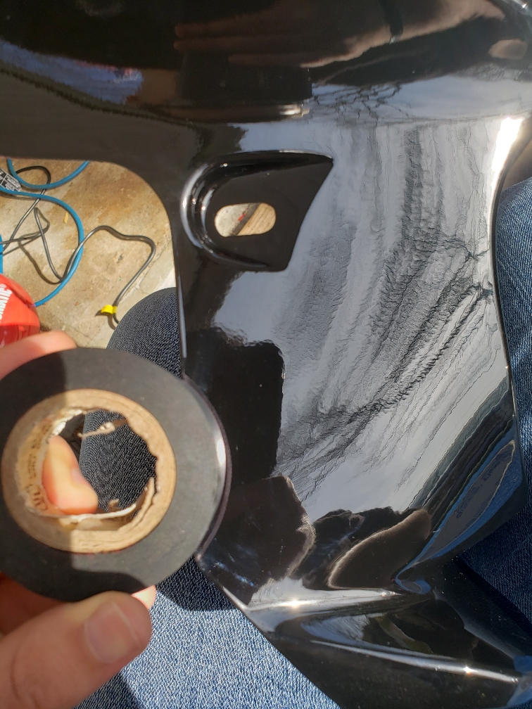

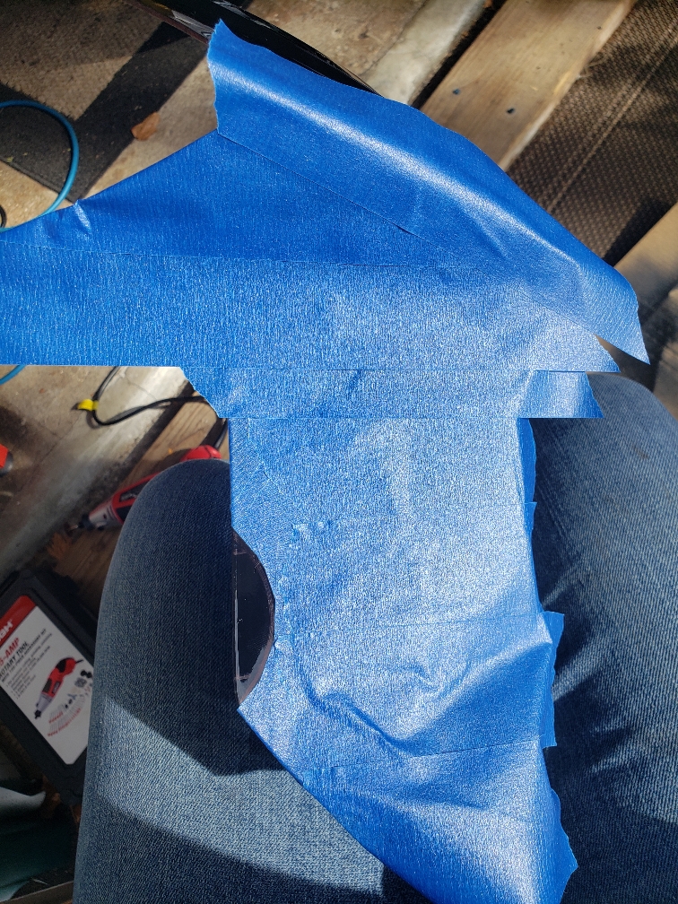

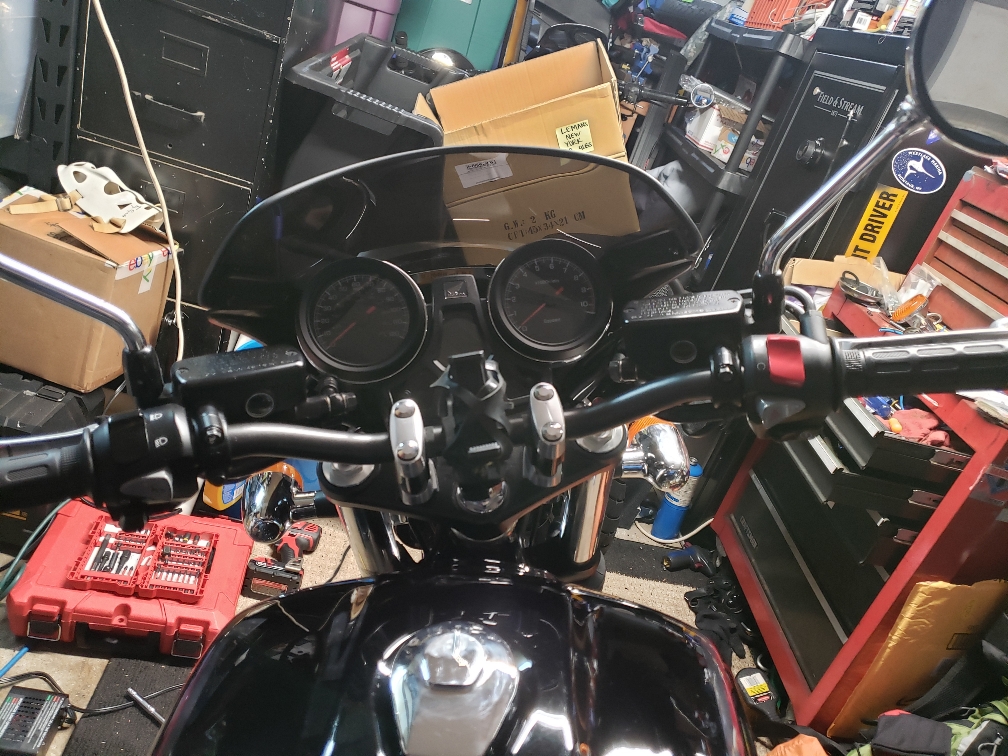

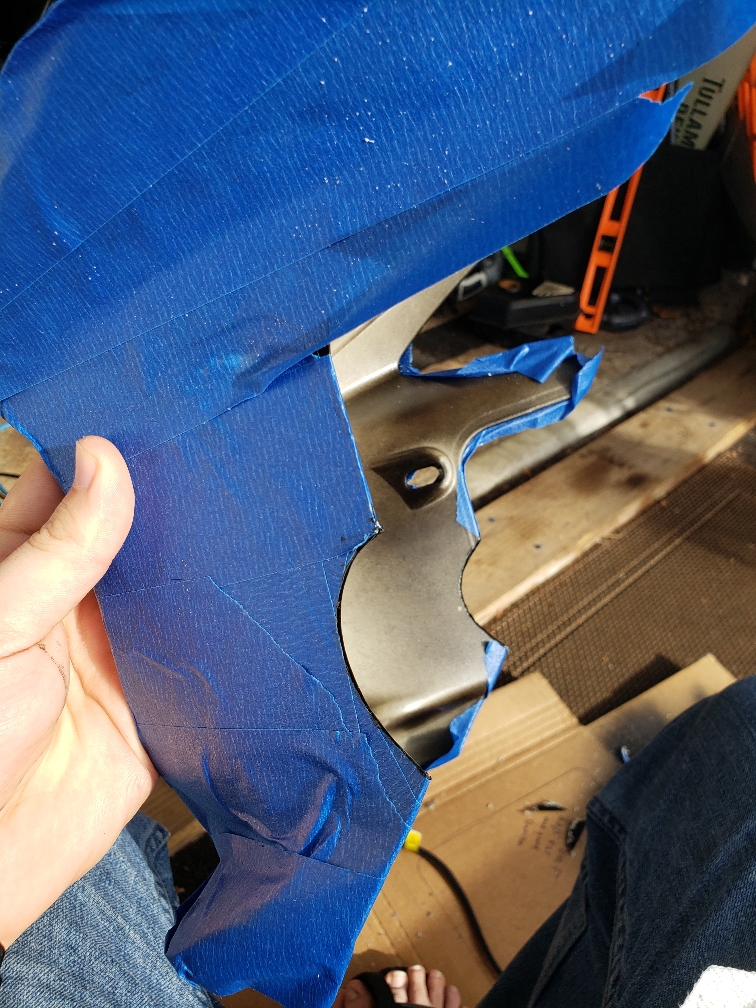

A few hours of cutting and grinding with the rotary tool.
She is complete and fits very well.
I kept all the spare parts from the universal Puig windscreens I have on another bike and had on the CB and everything I needed was in there.
- Spacer, longer bolt, washer.
- Puig also supplied circular foam pads that are sticky on 1 side so I used 1 on each cluster to keep the new fairing from resting/rubbing on the gauges. This also allowed me to use the supplied bolts from Emgo to secure the windscreen without the bolts making contact with my gashes.
- Cutting away the sides to make room for the turn signals was very easy. I measured 2 inches below the center of the bolt slot. Got 1 side done, then I lined up the flat edge of paper to the flat edge of the fairing. Traced the curve I made. And the. Transfered that to the other side (2 inches down again) so I had 2 perfect matching sides for the turn signals.
I gave the. A quick 220 sand to smooth the grinds up and then hit it with black paint match. (You could use black nail polish)
- i had to cut/grind away alot more from the bottom where you can't see in front of the horns so allow the fairing to push back far enough to like up with the headlight bolt. I then grinded away a bit more so the fairing wasn't touching the horns and wouldn't create vibration.
- i sprayed the inside of the fairing with plastic dip to..
A. Have an even black color on the inside
B. Reduce glare from the headlight
C. Makes it a little heavier and the rubberized coating helps reduce vibration
Learned that trick with my 93 Yamaha xj600 seca. Alot of guys would adhere rubber to the inside of the fairings to reduce vibration.
I apologize for all the pictures just being at the bottom and out of order. Im not sure how to insert them along the way in a step by step placement.
[Image: c4087887f377ca0fce5c92de0ec46ff7.jpg][Image: 5e471202d71e43cd01c71c9ba36a52bb.jpg][Image: dc7a562ddebb3ac5427e64d3b655f2e6.jpg][Image: 8074a2ffc7a4a1fb733812f630c41071.jpg][Image: 1a065bf7c1f771bfe98558cdc7c5b6f1.jpg][Image: ec68c308ae76c5c2f796a35f5757fc8f.jpg][Image: 3d6abbbac11f5f8e9a64038cc4e06766.jpg][Image: 7547a5cedefc61533028badecd0ad471.jpg][Image: d8ebc472faba2eb3b0bc1d4538f59e4a.jpg][Image: ad2a7d4bdbcf799e2f0db8b3ae62e8a5.jpg][Image: d987048038e21912f64e26e0bc76d00a.jpg][Image: da7a488637e096e7e1802ff7299d1cd9.jpg][Image: 259145b3c5de06a94b6a74862cf6017f.jpg]
And the rest of the photos/final product.
I'm probably just gonna change out the mounting bolts to black ones but I never had to go to the hardware store today so I will grab them when I get there. [Image: 5b39832557a37de00f18e777504506f4.jpg][Image: c6ea6b50e1cca627eab05e3734f286d7.jpg][Image: e7fefa1a26b51a225945a44b6fedbb86.jpg][Image: a1b2be16c3215aae58497cbf43a2b6c5.jpg][Image: 1f0bfaa06da274d85058037eccfa7e6c.jpg][Image: 335110cb5b8619d12132e1d525bdd66f.jpg][Image: 03624d7125997972dfcde954d5467cbb.jpg][Image: 94b638ec43cc560122606f7b7221e8f7.jpg][Image: 007414f0ba29992e4cf638e718ce0ddb.jpg][Image: 4834ad342975a3a2cac81cb6337a94dc.jpg][Image: b45dfee363ed0d410efdd9c20c859768.jpg][Image: fab89e9e1ddc2514217d1e4f254a3fb9.jpg]
