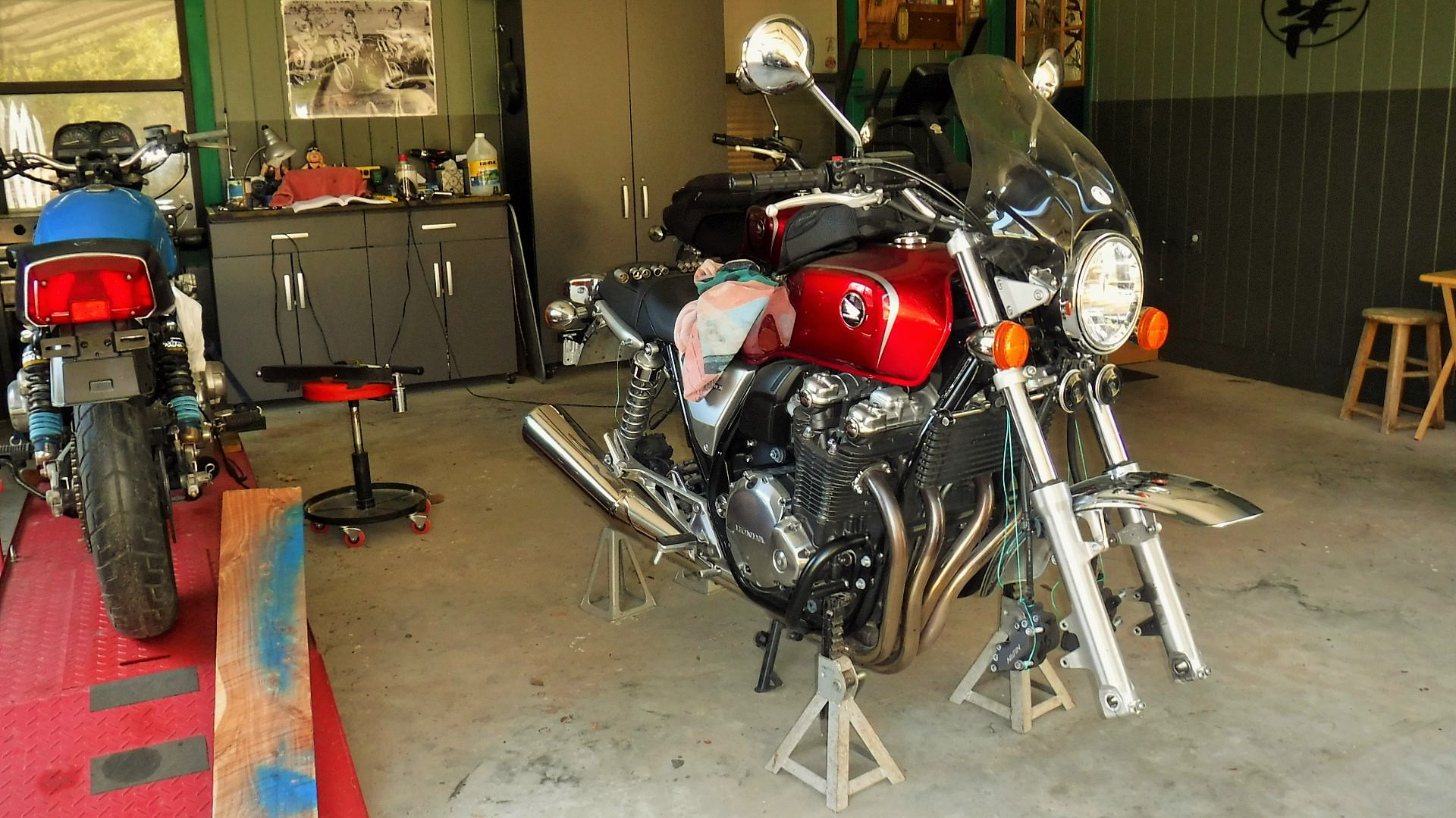

With the SW Motech crash bars installed it's easy to lift the bike for removing both wheels. A couple of jack stands are all that's needed.
[Image: 207aa706a1df7c675d637f3f606d8a89.jpg]
[Image: bc0bf793a87986befa3dc25dd47edf4a.jpg]
