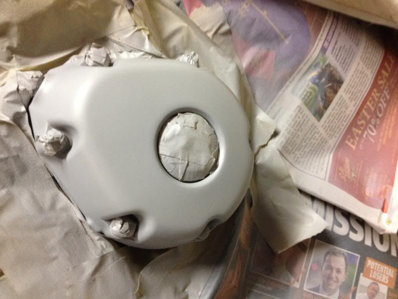

Masked up and etch primed

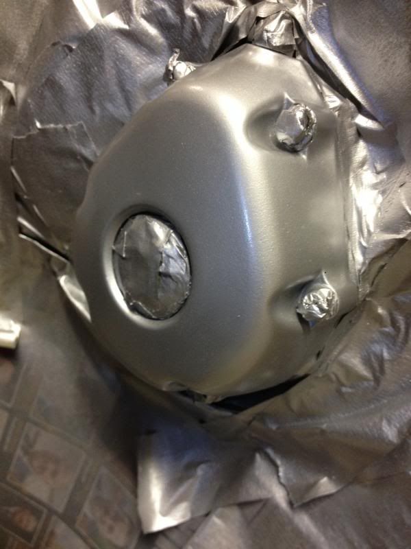

Aluminium engine paint
Three coats then Clear Coat, 2 coats

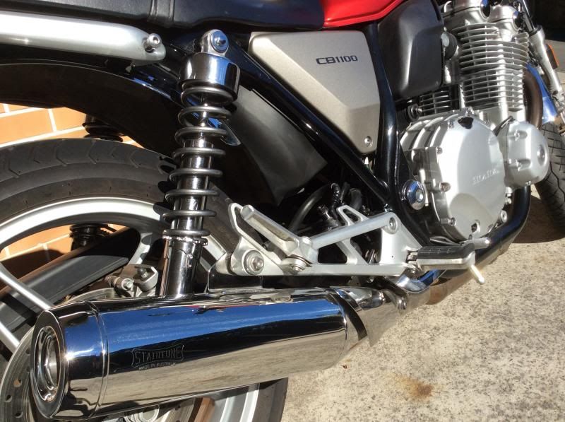

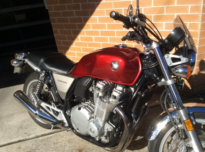

When it cures, I'll give it a little polish up and the Last Blast is (nearly) as good as new. Well, good enough for the Bush Mechanic.

Looks good. I couldn't tell the difference. How are you finding the Dart?

Cracking a smile here! Very nice work that Ptero. Can't tell it was ever damaged by the pics.
