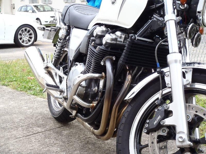

It has become obvious to me that the "cleaning off" of whatever rust or corrosion inhibitor on the pipes of my bike was not done properly. It was likely attempted, as I can see rag marks, and some of the pipes are less discolored than others. However, the rest look like I have 5 years of surface corrosion and spotting. Personally, don't care. I may attempt to clean it, buti t may help perpetuate the "Restored vintage bike" myth.

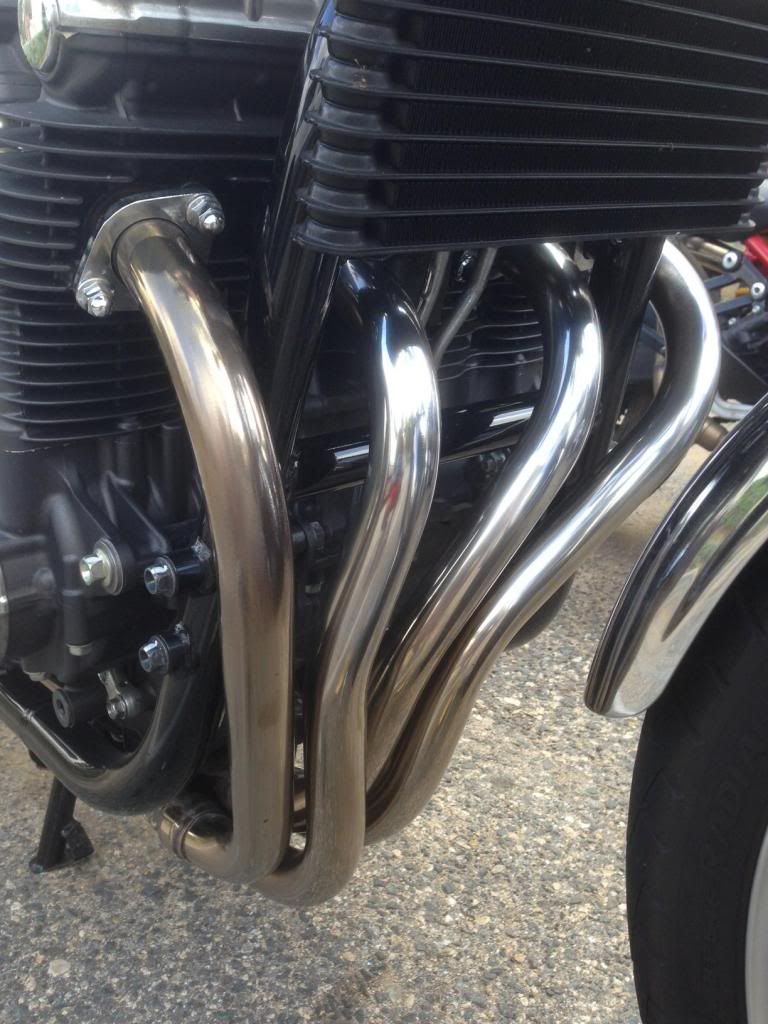

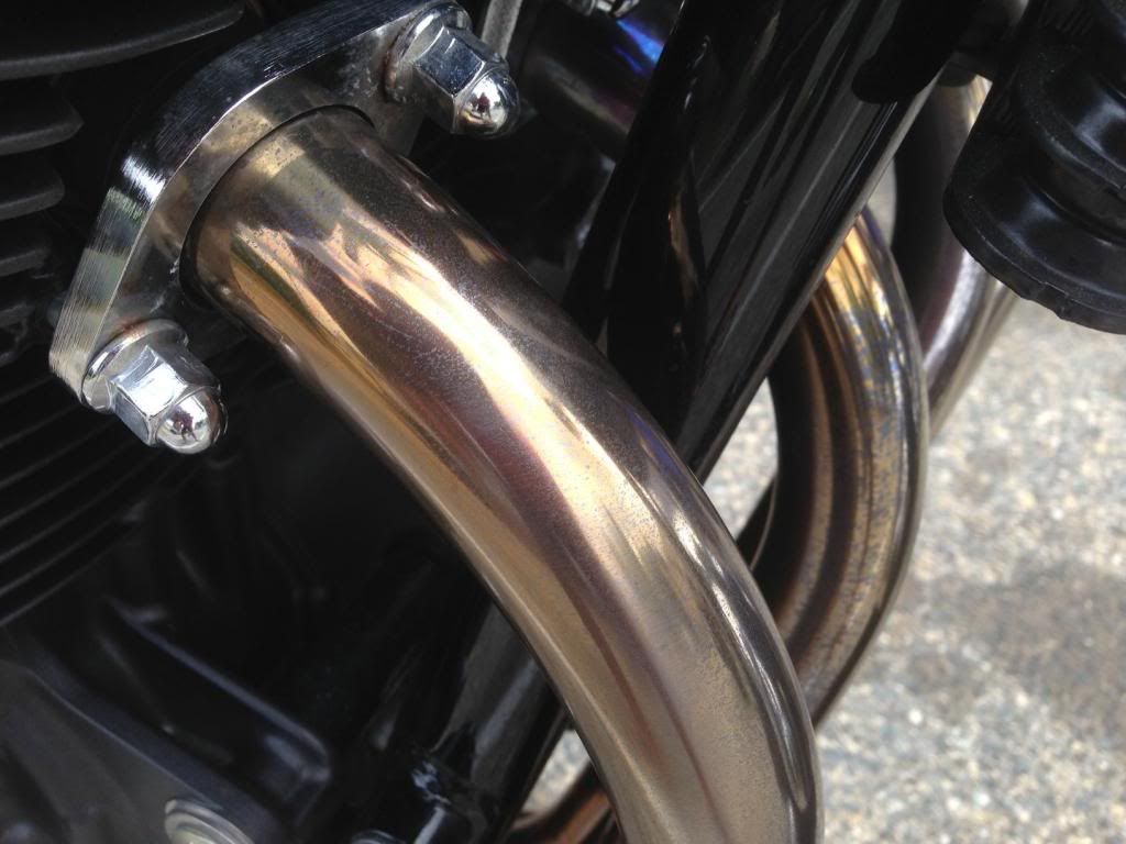

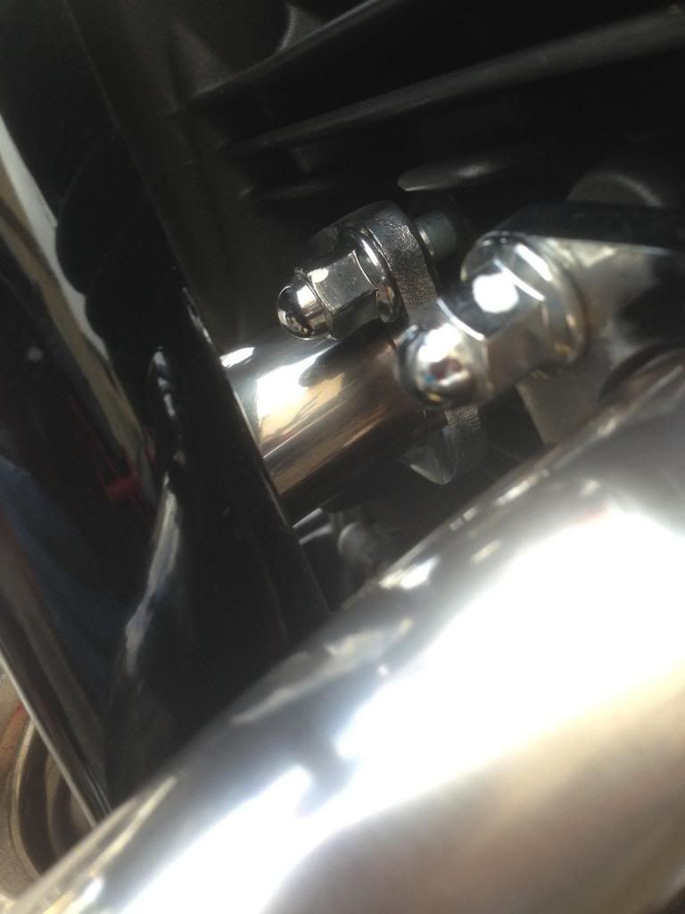

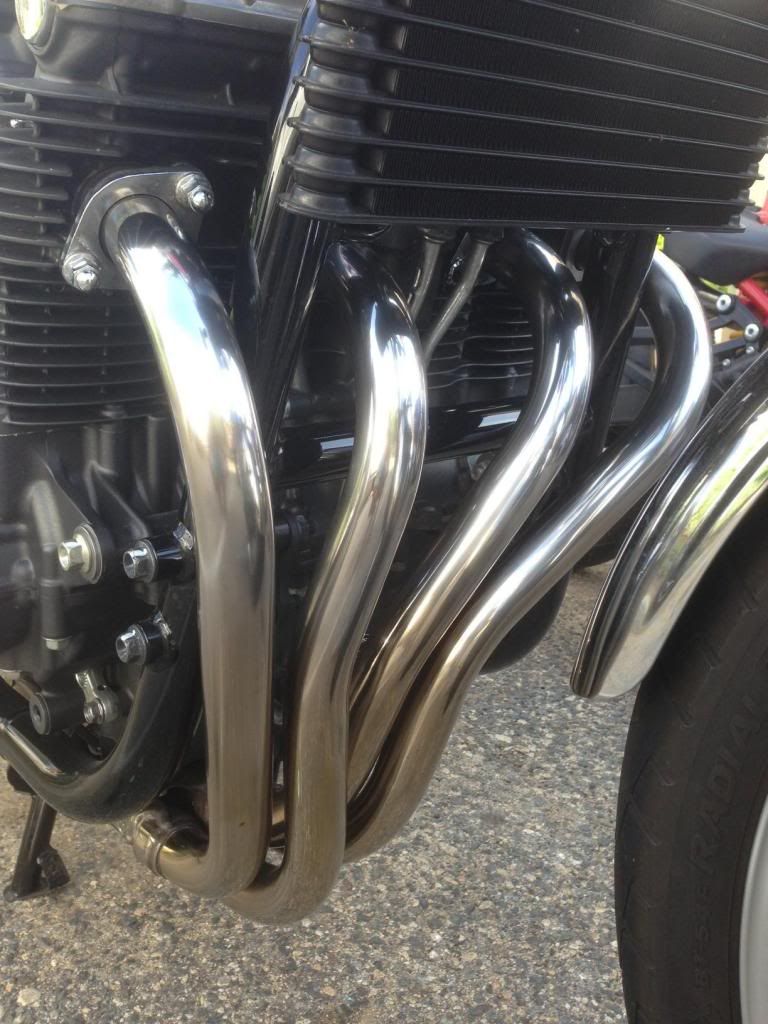

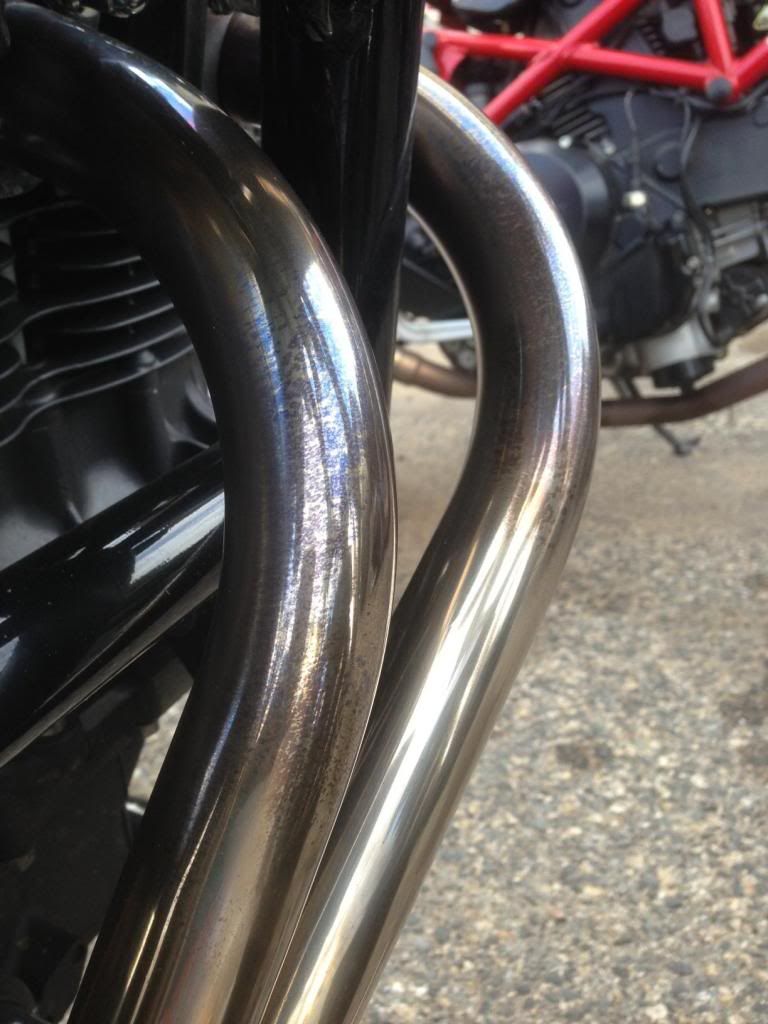

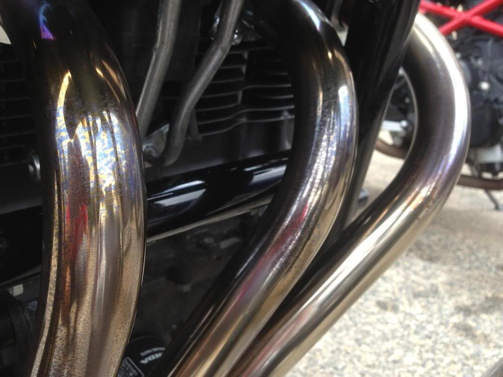

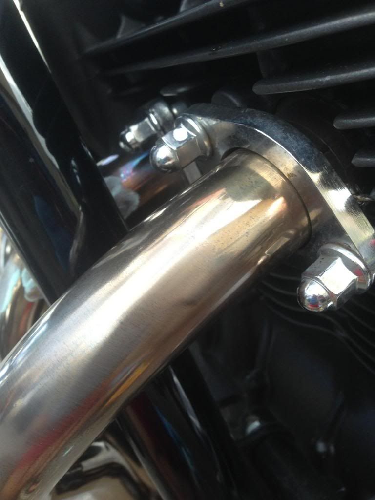

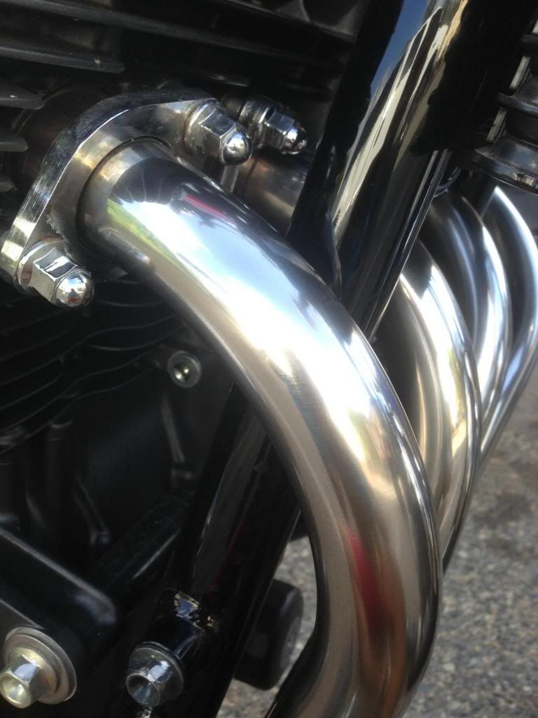

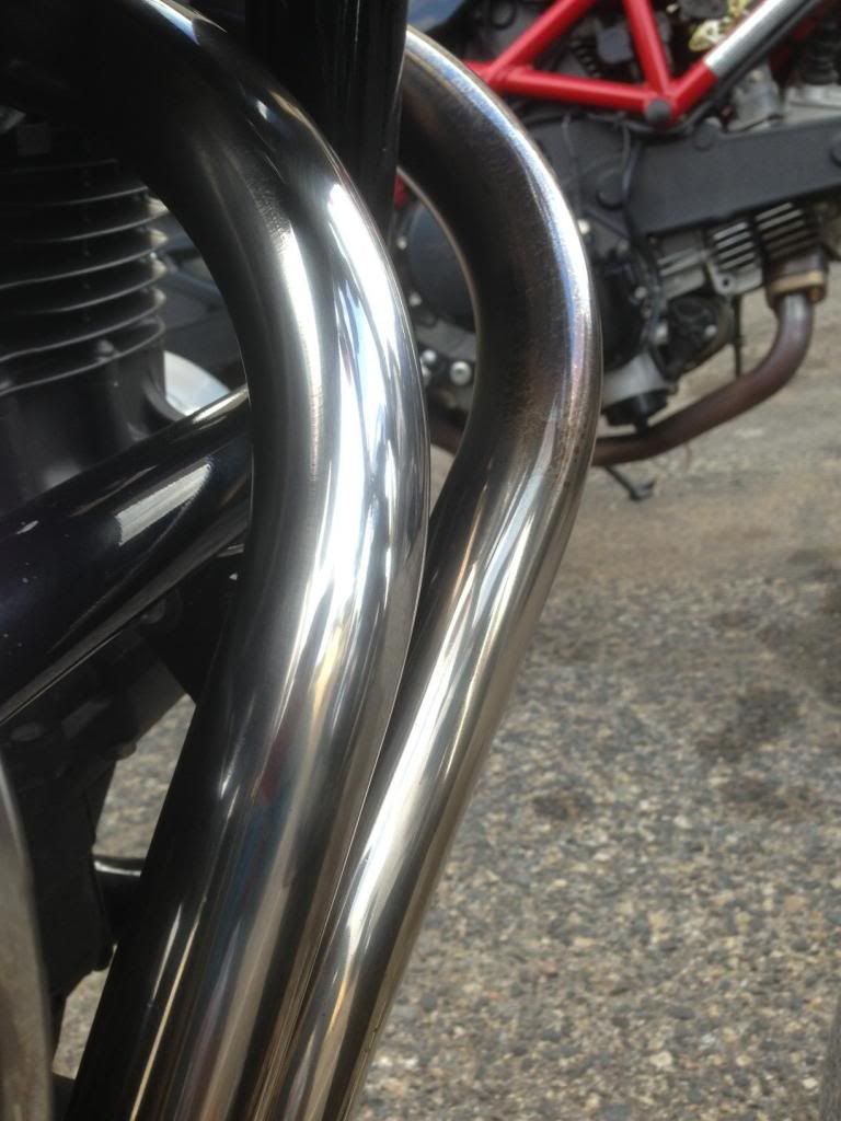

I used Simichrome blue away, #0000 Steel wool and a polishing rag and it worked GREAT to get the spotting and blue off! Maybe even TOO great haha. If you like the bronze color on the pipes then I don't recommend trying to get the spotting and bluing off (I think it doesn't look bad and almost liked them, I know some on UK forum like having the bluing because it shows they ride the bike hard) . I had quite a bit of spotting on mine and don't mind losing the bronze color. I'm taking a break and haven't decided if I want to do the bottom portion of the pipes or leave that part bronze.
Here are some before and after pics.
[url=http://s1329.photobucket.com/user/red_VIII/media/photo1_zps45654e48.jpg.html][Image: 2aaac83783711fa0ca2e9e240a051862.jpg]
[url=http://s1329.photobucket.com/user/red_VIII/media/photo2_zpsb058c19b.jpg.html][Image: a710780d515bdac77cf9136ab5a37181.jpg]
[url=http://s1329.photobucket.com/user/red_VIII/media/photo3_zps5382f5af.jpg.html][Image: 27630cd05ed82d8f3c7b6e3293a1e279.jpg]
[url=http://s1329.photobucket.com/user/red_VIII/media/photo4_zps1c0801c9.jpg.html][Image: 7423b2508176081d75d01e958da48191.jpg]
[url=http://s1329.photobucket.com/user/red_VIII/media/photo5_zps30754d6d.jpg.html][Image: 849d9b76bae4484956146ccfc9b43b64.jpg]

You can really tell the loss of bronze in these next two. The pipe on the far left wasn't that bad and I saved for last.
