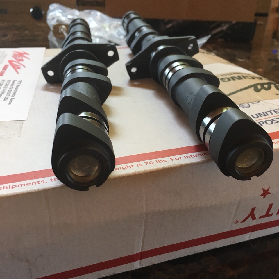

(07-14-2018, 02:46 AM)PowerDubs_imp Wrote: [Image: 97372cedcc09e2c048a833c6284cfce7.jpg]
Purty things Dubs.. hope they give you the power you were looking for. Never seen black ones before, only silver ones with polished lobes.
That is a moly lube coating that will wear off once fired
Those are some good lookin' bumpy sticks, PD! Can't wait to hear about the results.
That’s the skinny end of lobes on the intake (left hand cam).
Hope it works. It should have
no middle ground- either awesome or carnage.
After all this time we're hoping for awesome. Beer

Visually comparing both cams sitting next to each other, to me it looks like this would work on this engine as well.
Would probably be a cheap easy way for someone to both get more power/tq and also get straight cam timing instead of the factory stagger that many seem to want.
