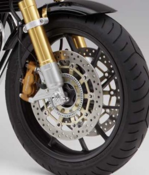

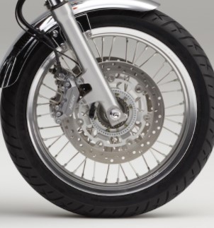

Last night I was comparing front-end photos between year '14 CB1100s and those of '17ex models to see if there was anything physically different that one could see. The obvious thing is that '17ex models have spoked wheels and the '14s (and jtopiso's "17 RS) do not. I began to wonder--bear w/ me, I'm no engineer--if the structure of the wheel could make a difference; for example does the wheel design--interacting with the attached rotor--make the rotor "behave" in such a way that w/ spokes "squeal happens" and that w/out spokes "squeal does't happen"?
Since I brought it up...
'14 DLX model:
[Image: d5d4af85cbf62a000ddd9825a32694a2.jpg]
'17EX:
[Image: 1cd534017f43357e1486d33df3419346.jpg]
RS model (not sure on year):
[Image: 73537529db31441db63bf7d11fb80106.jpg]
Rotor is different for '17ex and RS.
