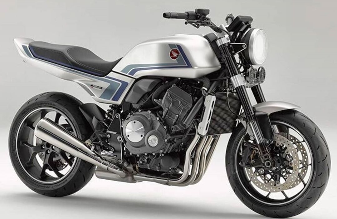

(10-12-2020, 01:06 PM)tod.branko_imp Wrote: It won't be a 60's 70's retro but the retro theme is changing, and we are slowly getting to the 80's, that's where the CB900f comes to play. Interestingly enough the 1100 project F was available in Japan, but Honda needs a liquid cooled performance machine to compete with the likes of kawasaki z900rs[Image: c442a255c3bbb0819aa880e2e178723f.jpg]
Sent from my ONEPLUS A5010 using Tapatalk
This bike looks fantastic to me. Makes me wish that I had ridden active dirts CB1000R at the rally.

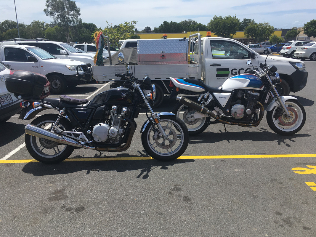

And ... on the other topic, I went to the hardware shop yesterday and by some amazing coincidence ...
[Image: 31f7e19690798fe671bae56b210a308e.jpg]
Finally, Ferret, who is this active diet of whom you speak?

That's what I get, when click in the image:
Your connection is not private
Attackers might be trying to steal your information from i.postimg.cc (for example, passwords, messages, or credit cards). Learn more
NET::ERR_CERT_DATE_INVALID
Dodgy
#76
peterbaron, I think that's the result of Google Chrome's latest security controls. The picture was meant to embedded in the post (I see it now is). When I followed through the reading with Google, it said that postimage is usually secure and that the problem should resolve. Seems it now has. I can see the picture I posted [url=http://cb1100forum.com/forum/showthread.php?tid=12241&pid=278195#pid278195]here.
#77
Works now, Thumbs Up
