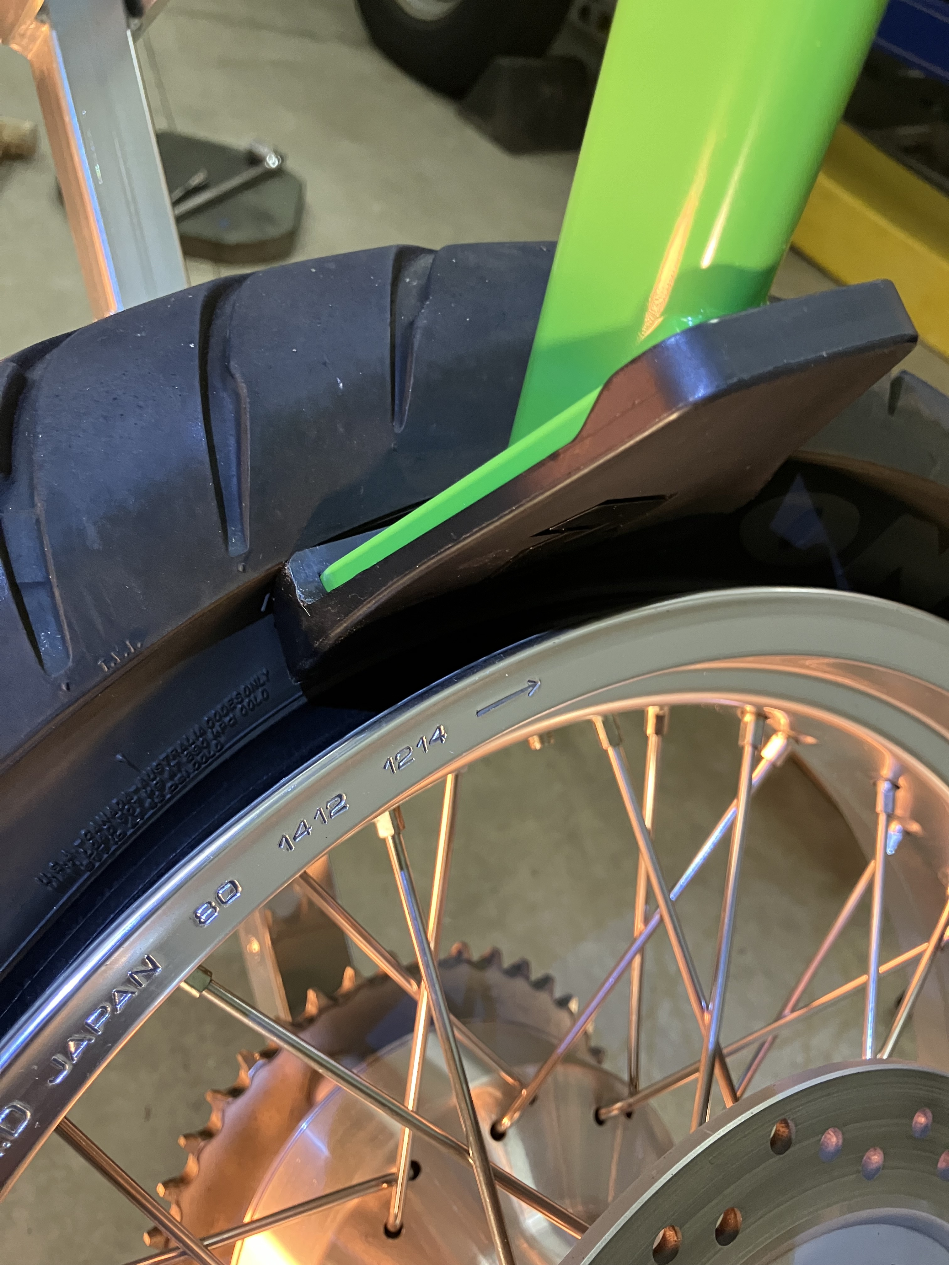

Round 2...this time with the CB1100, rear. Last night I went slow as this is my first time with wheel removal on the Honda. Came off nicely thanks to some tire removal suggestions from the forums. Cleaned the chain and sprocket, then went all crazy clean and scoured all accessible areas with the wheel removed.
Tonight, I re-assembled the Rabaconda and went to work. Had the tire inside all day and with a little extra help from the space heater the tire was nice and warm.
Breaking the bead is frightfully easy. I mean, I barely pushed around the rim one entire turn and by the second it just peeled off.
[Image: eb810bb9159acaa7234fe955ffc27f31.jpg]
The contact point of the wedge is easily adjustable to accomodate thin and wide tires.
