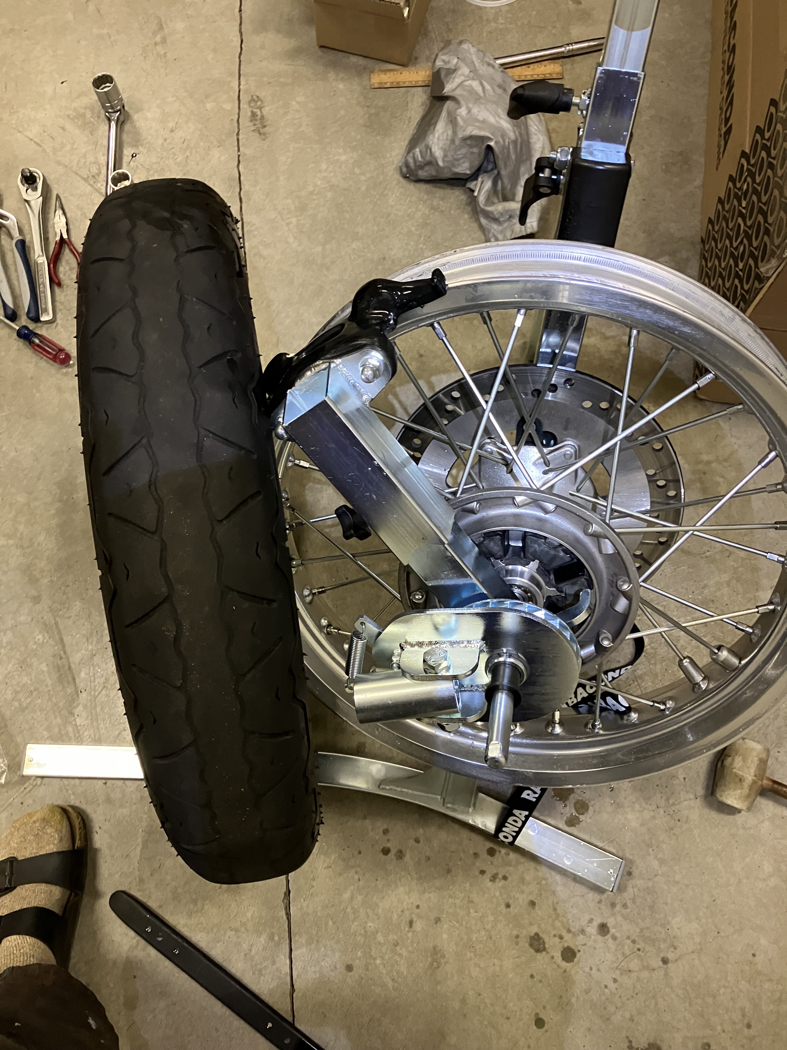

Took my time, got the stand set-up, looked things over, rewatched videos...and started. Took me a few minutes to realize just how to go about it, but broke the bead and had the tire off in just a few minutes of actual work time.
Getting the old one off
[Image: 6ef8219e4ae48710c785c7ad026c4bc2.jpg]
Literally, just minutes
[Image: 6b1a435f8bfd971209d6e0154e4d775a.jpg]
And then on with the new. This took more time as the mechanism that does the heavy work slipped off a few times and I had to start over, but still...less than 20 minutes and it was on:
