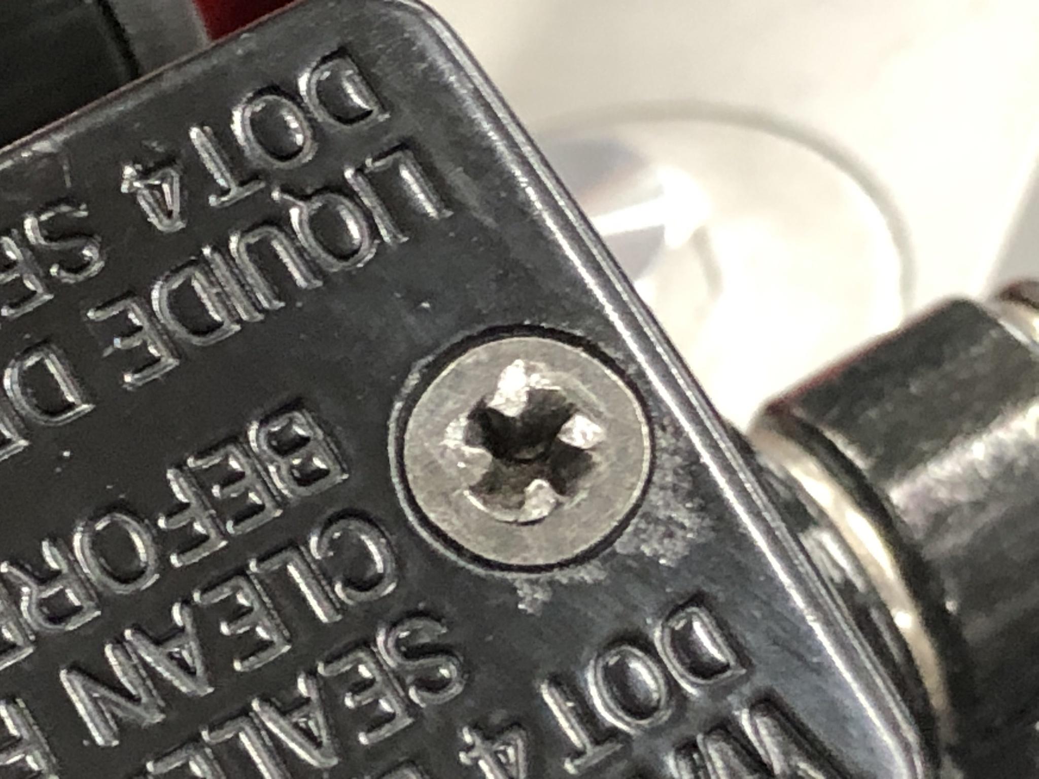

(06-15-2021, 06:50 AM)Stichill_imp Wrote: Went to bleed the brakes on my CBR250R and one of the cover screws wouldn't budge, even using the proper JIS screwdriver. It started to cam out and displace metal in the screw head.
I decided to get a ball-peen hammer and carefully beat the protruding metal back down into the screw head. This made the screwdriver fit very tightly and I was able to break the screw loose by momentarily turning it clockwise and then counter-/anti-clockwise.
This is the screw after I loosened it:
[Image: c63b8054c089224357f43d54073f8527.jpg]
Looks like there's some galvanic corrosion happening between the screw and the cover, so both will be replaced with new + a small amount of anti-seize compound.
This method was less scary than a drill and a tiny back-out, and saved the master cylinder itself from being damaged.

(06-15-2021, 11:10 PM)LakeWylieJoe_imp Wrote: The brake/clutch fluid is supposed to be bled/replaced every two years. Has that cover ever been off before?
Oh yes. I have speed bleeders and do this once a year.

I'm a big user of anti-seize for most bolts that are prone to sticking, which are usually the larger ones that aren't removed often. It's a bit unusual for small screws like this to seize. I think it's the large surface area under the head that forms a bond which can't be overcome by the rather weak JIS crosshead. (Edit: I see that jtopiso agrees.) I saw the ball-peen method of screw rehabilitation on a gunsmithing channel. It's very common for people to use the wrong type or size of slotted screwdriver on gun screws, and end up damaging the screw slots. It would be tempting to file off the displaced metal, but the integrity of the screw is better preserved by lightly tapping the metal back into place with a polished ball-peen hammer.
(06-15-2021, 04:46 PM)jtopiso_imp Wrote: A countersunk bolt has a lot friction under the head, specially if it hasn't been loosen for a while. A drop of wd-40 on the perimeter would've helped.
Good point. It was a surprise to me that this one was stuck. The other one loosened without incident.

I put a the screwdriver in place, put some loosen torque on it, and tap the end of the handle with a ball peen. It transfers the shock into the screw and breaks the "set". For really stuck ones, put a few drops of WD on it, let it sit overnight, and do the ball peen thing.
