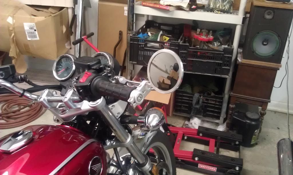

I was looking at a set of Renthal bars at the dealer's last week and was wondering about my bar end mirrors fitting. The Daytona sounds like it may be a better, and definitely cheaper, option.
[url=http://s168.photobucket.com/user/blcross/media/IMAG0674_zps3125d44e.jpg.html][Image: 6f3418c9761764fd58424d80492eda1e.jpg]
