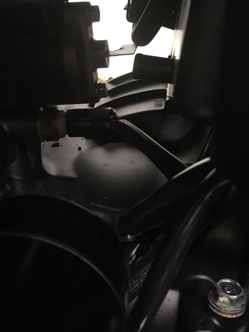

In prepping for this I took a quick glance at a few threads. Saw a mention of using a screwdriver on the tensioner instead of the special tool.
No way to fit a screw driver in the small space between the airbox.
Just went back and looked at the pic on that thread- it’s not a CB1100 pictured.
Ugh.
Made a ‘tool’ out of scrap. Now back to work. Smile

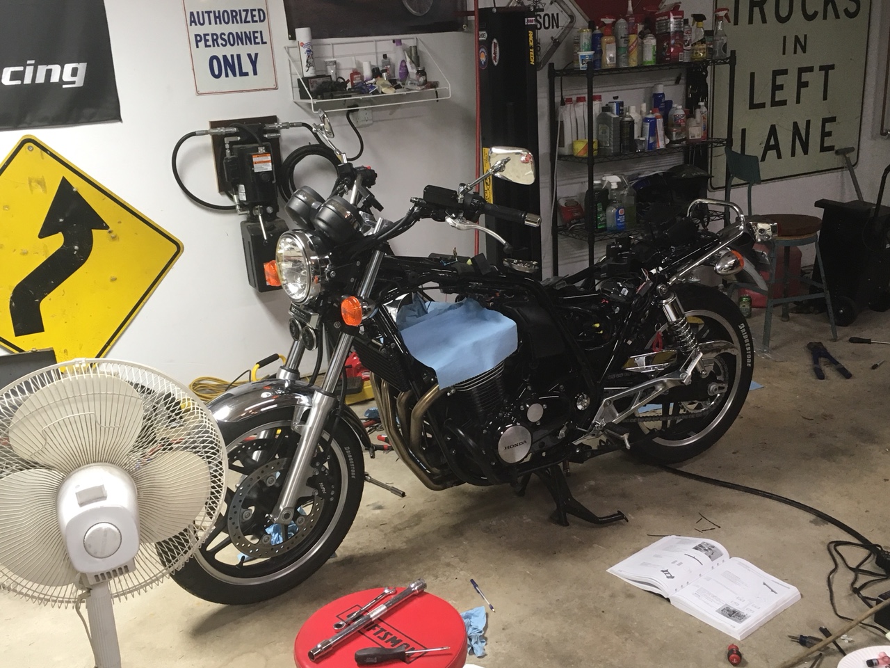

Cam caps- the reason why god invented a 1lb deadblow!
[Image: 5c21e1ae4d987ad66e67bd50a3027e9a.jpg]
Stock cams out. Yea- from what I can see the exhaust cam can swap into the intake spot for even timing of someone wanted to do that.

That’s enough for today- time to spend some time with my wife.
