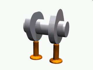

Those numbers are basically when the valve opens and closes and how far.
For comparison here is the initial stock #'s the shop gave me (before they realized the split timing on the intake)- http://www.cb1100forum.com/forum/showthr...#pid154178
[Image: 6b056f94c9231c137a2d070ed68565b6.gif]
[Image: 97372cedcc09e2c048a833c6284cfce7.jpg]
Excitement would mount, but the head valve cover has to come off first to fit the new cams. Thumbs Up
Be interested to see them beside the OEM.
