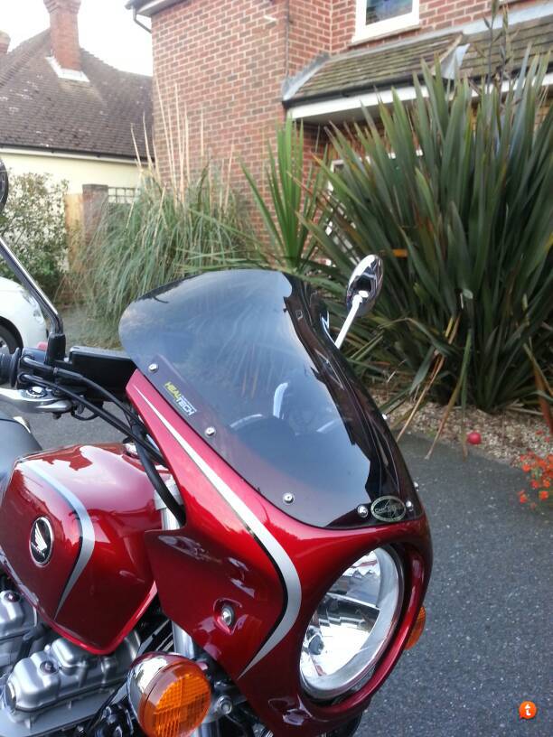

Here is the Chic Design Road Comet II with Aero screen:
[Image: ecbba8fd9339dfc79c4f919ba32e7367.jpg]

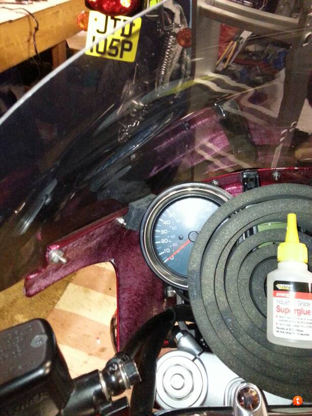

Whilst I was very pleased with both the quality and ease of fitting, I was not happy with the way it bounced around at anything over 60mph (the very speeds I bought it for! )
I was trying to work out how to make a couple of additional support brackets when I found an easy solution on this forum:
[Image: 0e31c769ad0a03e39ab75dc955705439.jpg]
Just super glue to join two bits of foam tape together to get the thickness and then squeezing it in between the screen and the speedo/Rev counter. It is now brilliant and has transformed what was a tiring 70mph ride (that I regularly do) into a pleasure.
