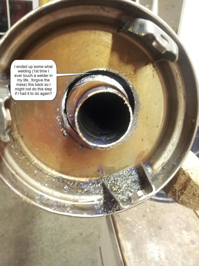

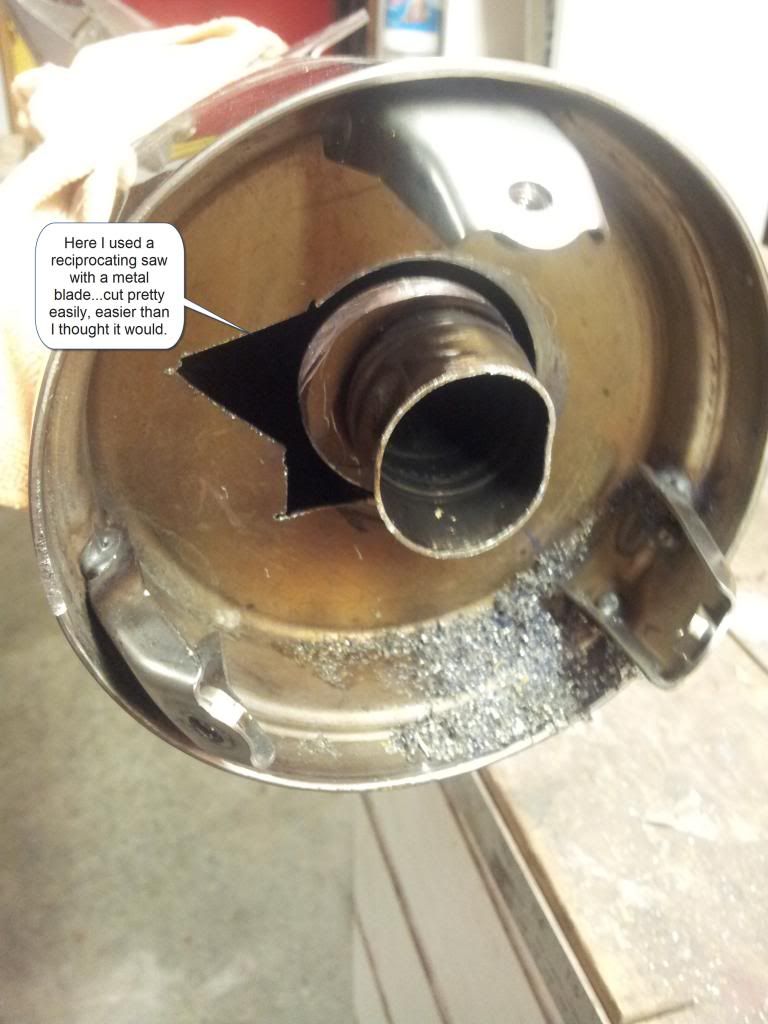

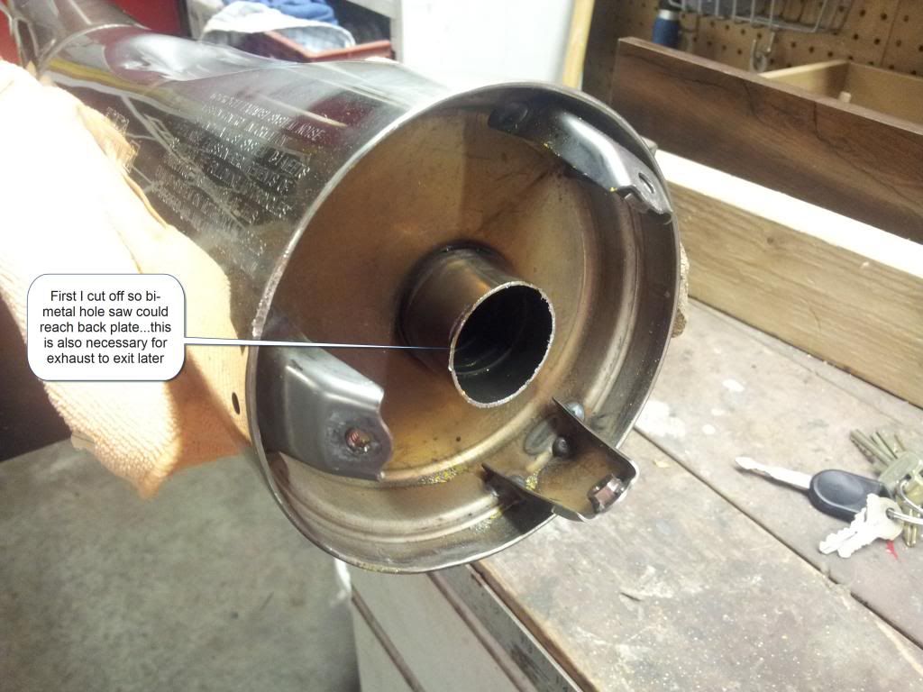

OK, I know this is kind of a hack job, but I bought a used muffler to experiment on.
I've learned some things....the baffle is attached BOTH at the front and down inside the muffler.
