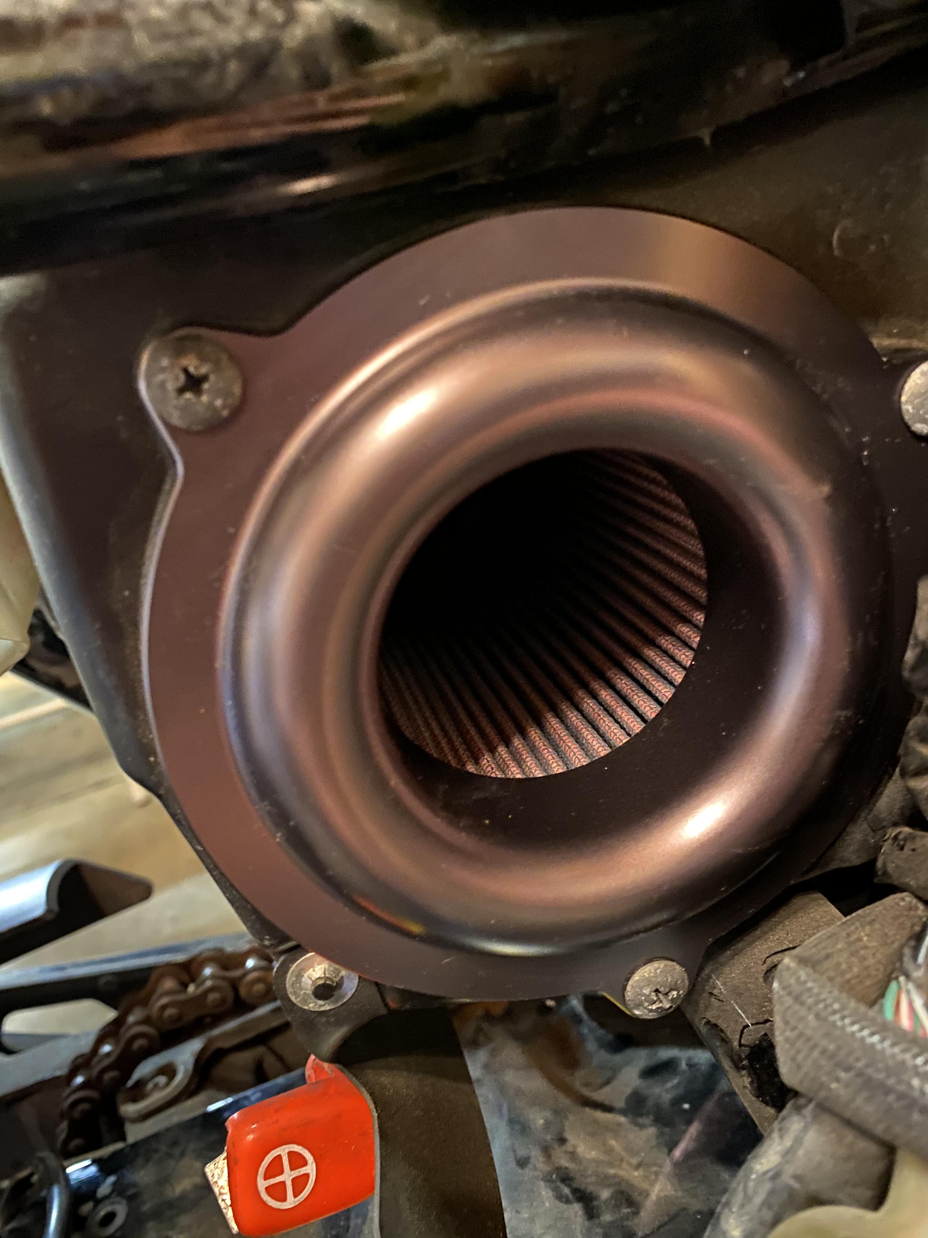

https://www.ebay.com/itm/HONDA-CB1100-RS...SwnpBbSPhR
Not the TSR branded piece but same exact thing, just installed one on my CB along with a K&N filter last weekend
[Image: cfa9a30e33da13f9a11fcacabe3510c9.jpg] Hey thanks! How does it feel? I know there were some worries about this allowing water into the intake in a hard rain.. thoughts?
[Image: 113185fcf8256c449abdbf985ae2d731.jpg] Hey thanks! How does it feel? I know there were some worries about this allowing water into the intake in a hard rain.. thoughts?
I'm shooting some emails out to get quotes to tune the power commander once I drop the velocity stacks in and slap an exhaust on.
Feels great for me personally, there is a bit of an added noise during air intake while on the throttle(which is perfectly fine by me) but it 100% looks like it breathes better than it did with the stock snorkel that pulled air from the rear mudflap, while this is a questionable design-to me- I know the engineers spent thousands of hours getting it right and the bike was designed for the purists and not the hooligans in mind.
I believe Josh(PowerDubs) came up with an alternative where you drill 3 holes on the left side of the air box instead, since he did not exactly like the newfound intake noise of the funnel plate produces vs. stock.
I think whether rain/water is a valid concern for some comes down to and depends on your weather/riding conditions.
I don't ride in the rain much if at all, but as far a I can tell, you should be fine as long as your side cover plate(Right) is properly installed. Rain isn't a big concern for me, but it may be for someone who does cross-country trips with unpredictable weather conditions.
[Image: 00b03dcc8abe51f0aee339d6ff8602cb.jpg] Hey thanks! How does it feel? I know there were some worries about this allowing water into the intake in a hard rain.. thoughts?
I think I'll be looking into a V-stacks setup as part of my next "performance upgrade" Nice I think im gonna a order it then. I like touring so like you said I can't always expect perfect weather when I'm on the road for a week and far from home.
But I could always just slap the snorkel back on when I know I have a big trip. I usually go through the entire bike and modify a few things for a trip anyways.
