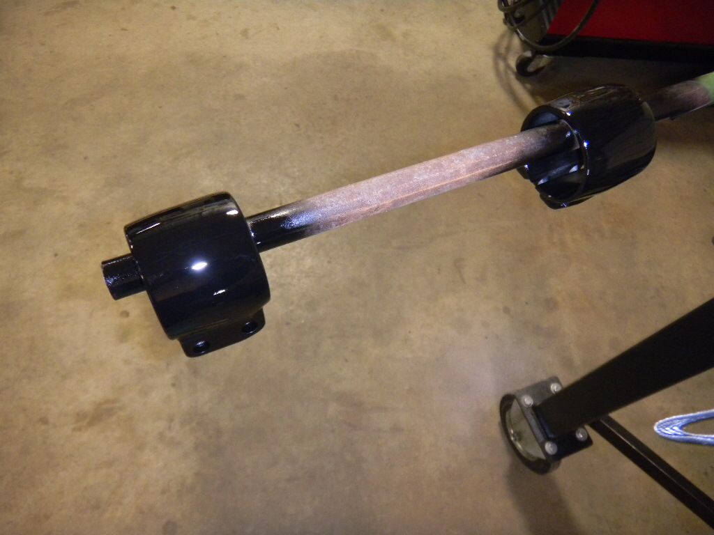

More to share.
The headlight bracket clamps that I bought were to big (brackets hit the tank, didn't want to reduce the turning radius).
Ended up getting a used/damaged lower triple tree. Cut off the ends, flapper wheeled them down, and then finished them off with 120 grit paper. Bead blasted them afterwards.
Left one is just after the flapper wheel, right is done, ready for paint.
[Image: 1b60b777f79655416949d2a8a4cd85a7.jpg]
Two coats of epoxy paint.
[Image: 7b1f82eb33b1d48582a8a4a30526849e.jpg]
Installed
[Image: 10c2cb304e737e5415522d5a4649f310.jpg]
Misc
[Image: 14efb5d5f9ed90cab5d740fea703bb40.jpg]
[Image: 5d84f5b0fa593ee81ce642f217fbb4ff.jpg]
