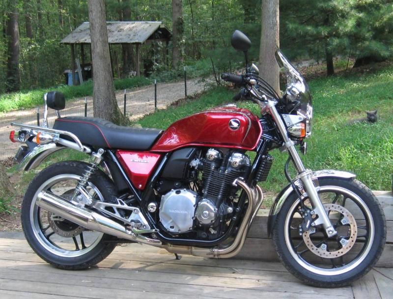

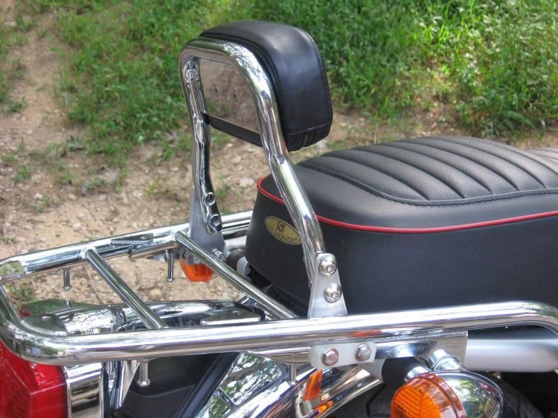

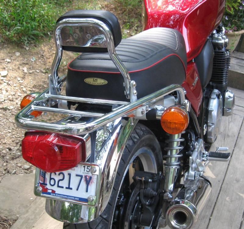

Mike mounted a Jardine short backrest onto a Honda rear carrier. I wanted a lower profile setup so I went with the Jardine mini backrest.
The mini backrest wasn’t a perfect fit, so I made a pair of makeshift mounting brackets using 0.2” thick aluminum plates.
I started by drilling a couple of holes in each side of the carrier. Since the carrier sides are angled, I made some wedges from an old cutting board that my wife will never miss, and I placed these wedges on either side so the mounting bolts would be in line with the sissybar
Two ¼” x 1.5” stainless steel bracket mounting bolts go through the wedges and the drilled holes in the carrier. The bolts in turn hold 2 aluminum plates in place. The backrest then mounts to the plates.
More than a few folks would consider it sacrilege to cob together plastic and aluminum bits to make a mounting bracket and attach them to an otherwise nice motorcycle. But I was getting tired of not finding a good sissybar solution. This will do until I find something better. It’s very solid and will make my wife much more comfortable. Plus now I can goose it with the wife on the bike and not get yelled at (as much).

Pretty darn nice! Is there a spacer or rubber mount between the Rear Carrier and the OEM bracket, where the bolts attach?

(08-31-2013, 03:13 AM)Tripod_imp Wrote: Pretty darn nice! Is there a spacer or rubber mount between the Rear Carrier and the OEM bracket, where the bolts attach?
You can see a white piece on the right side of the carrier in the 2nd and 3rd picture. That's one of 4 wedges fabricated from a 1/2" thick cutting board. One is on either side of each of the rear carrier's "side plates" to square things off.
