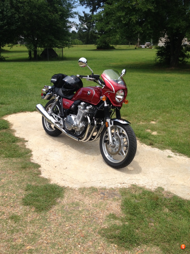

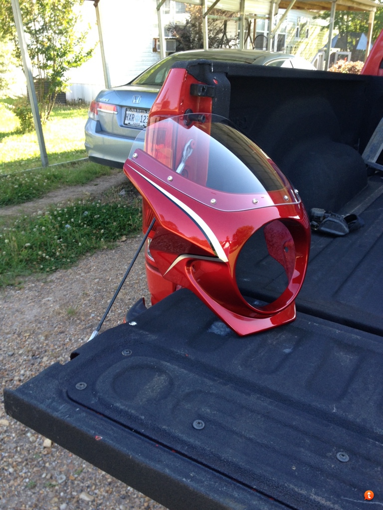

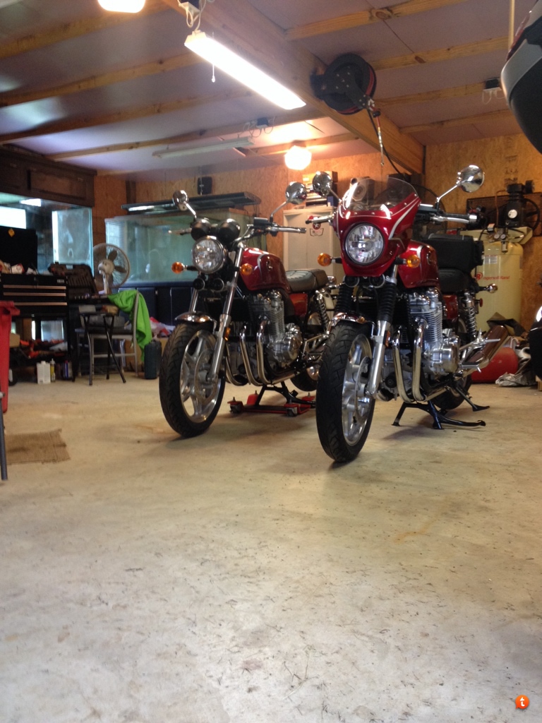

I have the comet 2 on my 14 deluxe. Not with taller screen. There is a post in here some where showing both pics to compare someone will read this and post that pic. It mounts to the headlight bucket on each side the kit comes with new screws and one L shape bracket at bottom mounts to horn bracket very easy to mount. Is your bike a 13 or 14?
